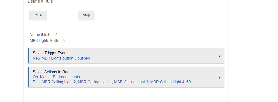

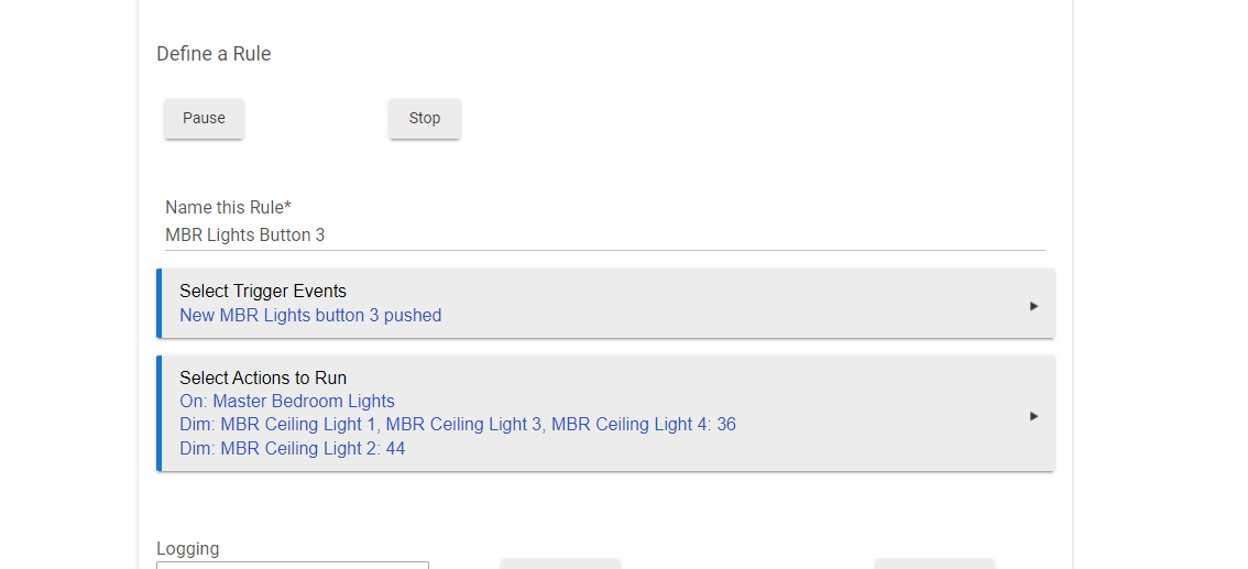

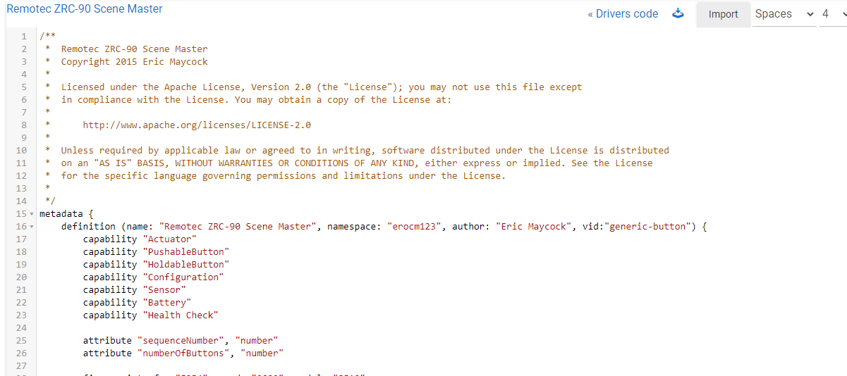

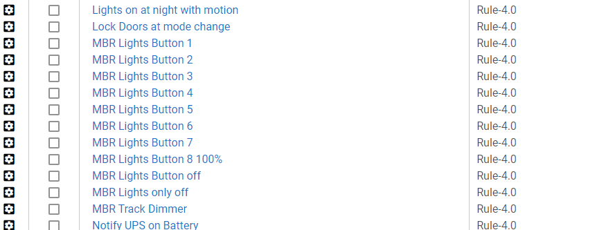

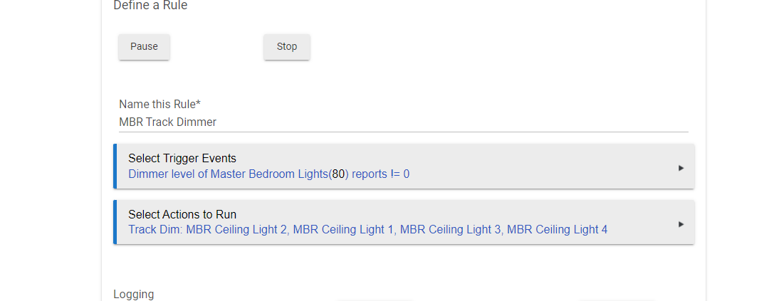

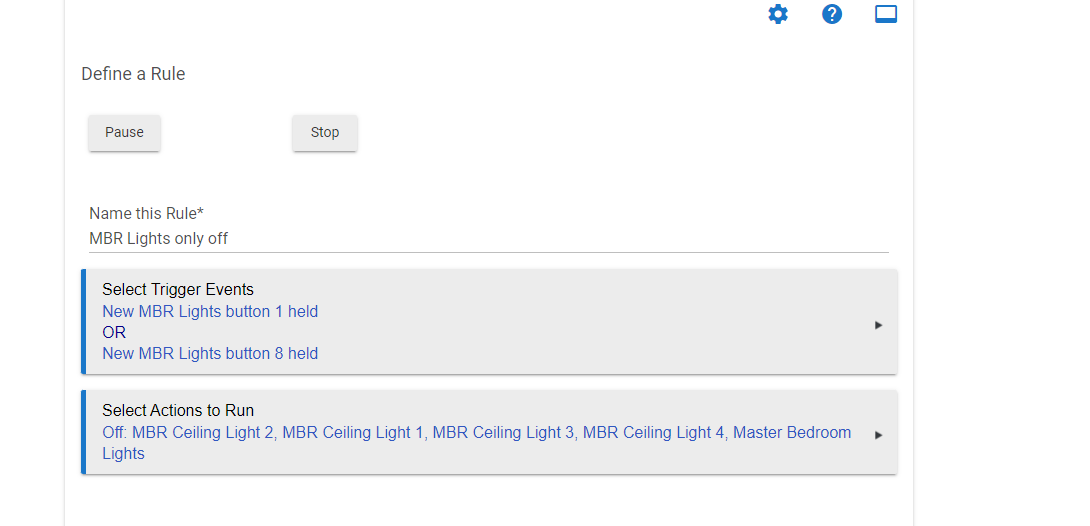

for remotech i am using the driver listed below and dont use button controller but yuo can see what type of rules i have below.. mine is kinda complicated becuase i have a fixture with 4 bulbs of varying manuf. and need different settings of each to get simliiar brightness and color..
