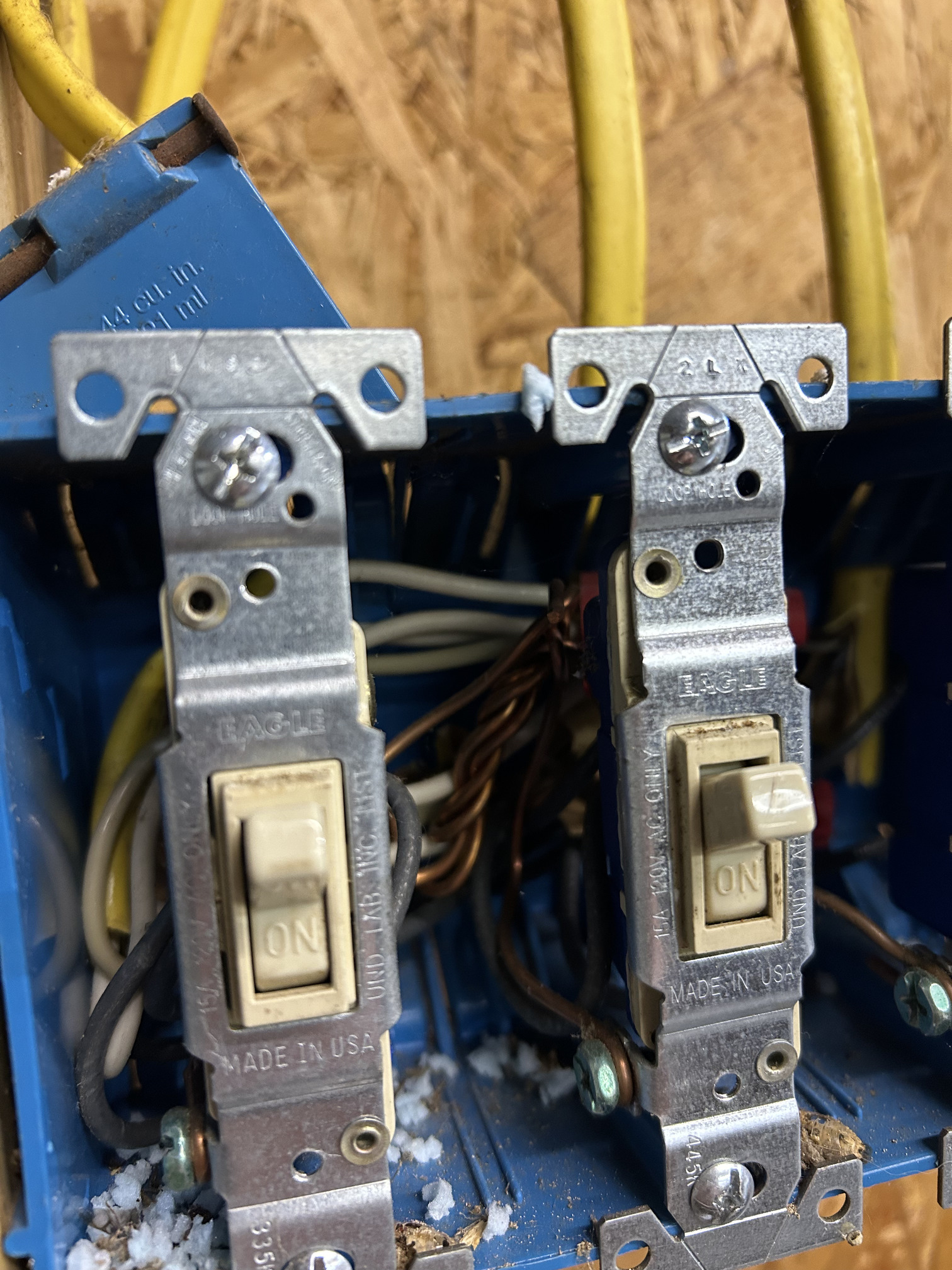

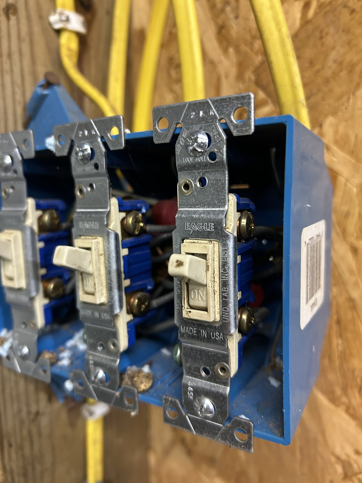

Here are a couple pics of how the switches are wired. Looks like neutrals are all bound together and the hots are split at the switch. Pretty standard. The third switch is connected to an outlet where the garage door is plugged in. I don't know why you would put your garage door on a switch. I will probably take that switch out and wire it hot all the time.
TBH, the way it looks wired, you can use any zwave or zigbee switch you want. Neutrals appear to be available in the box, so you’re good to go. The only thing I can advise is that it’s all wired in 12AWG (like I wired my house), which means you’ll have a bit more effort cramming that wire back behind a smart device. Definitely doable, but gets a bit tough when you pack three smart switches into a 3-gang box.
