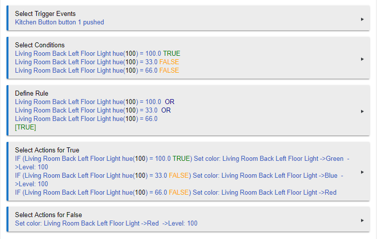

That's a fun one to try to figure out.
If those are the only colors you are using, this should work.
But it only works because you chose colors in your example that are dependent on hue while keeping saturation at 100%. A color like "pink" will adjust saturation as well so the above method wouldn't work. Color temperature (bright white, soft white, etc) also wouldn't work with a rule like that.

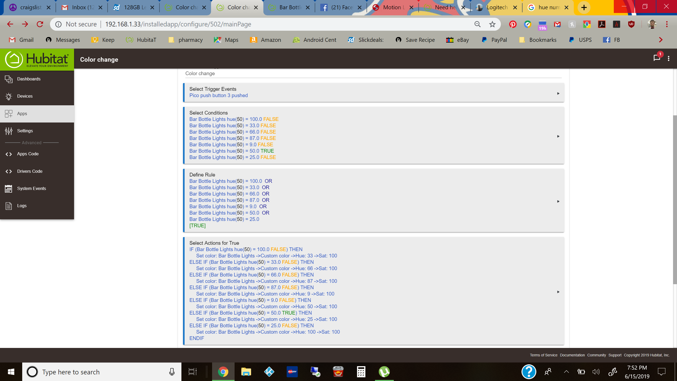

I've done the same, but with different scenes.
I used a global variable for the rule...

I ended up doing this, thanks for the help works great, although it is a lot of work for such a small thing.
