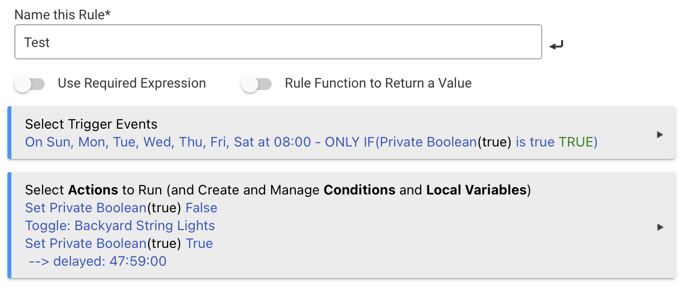

There are several ways to do this. Here's a method in Rule Machine that uses a Private Boolean:
It relies on requiring a PB to be true for the trigger to function. The first action sets the PB to be false, and the last action sets it to be true just before the next desired execution time.

aaiyar: some questions (have not used the private boolean before). First, how do you add the "ONLY IF" restriction to the trigger events for the PB? Also it sounds like this needs to be done in the rule machine app rather than in room lighting where I was doing it (which is fine with me). For more detail... I'm trying to have an automation that turns on roof heat tape from 8am-8pm every other day.

You would need to use a conditional trigger in rule machine.
This doesn't work?
@user897 - what @hubitrep has posted is the simplest solution. It makes use of the Periodic Trigger in RM.

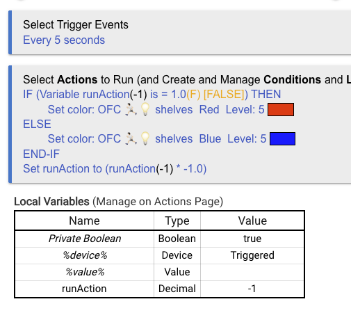

This is can be used in much more complex situations. Say there are several outcomes that might happen in each cycle. All they need to do is multiply the test variable by -1 and not have to worry about the current state. The individual branches wouldn't have to evaluate the variable before changing it. In many languages the 1 will evaluate as true and the -1 as false making it even simpler.
if (runAction) { ... }
