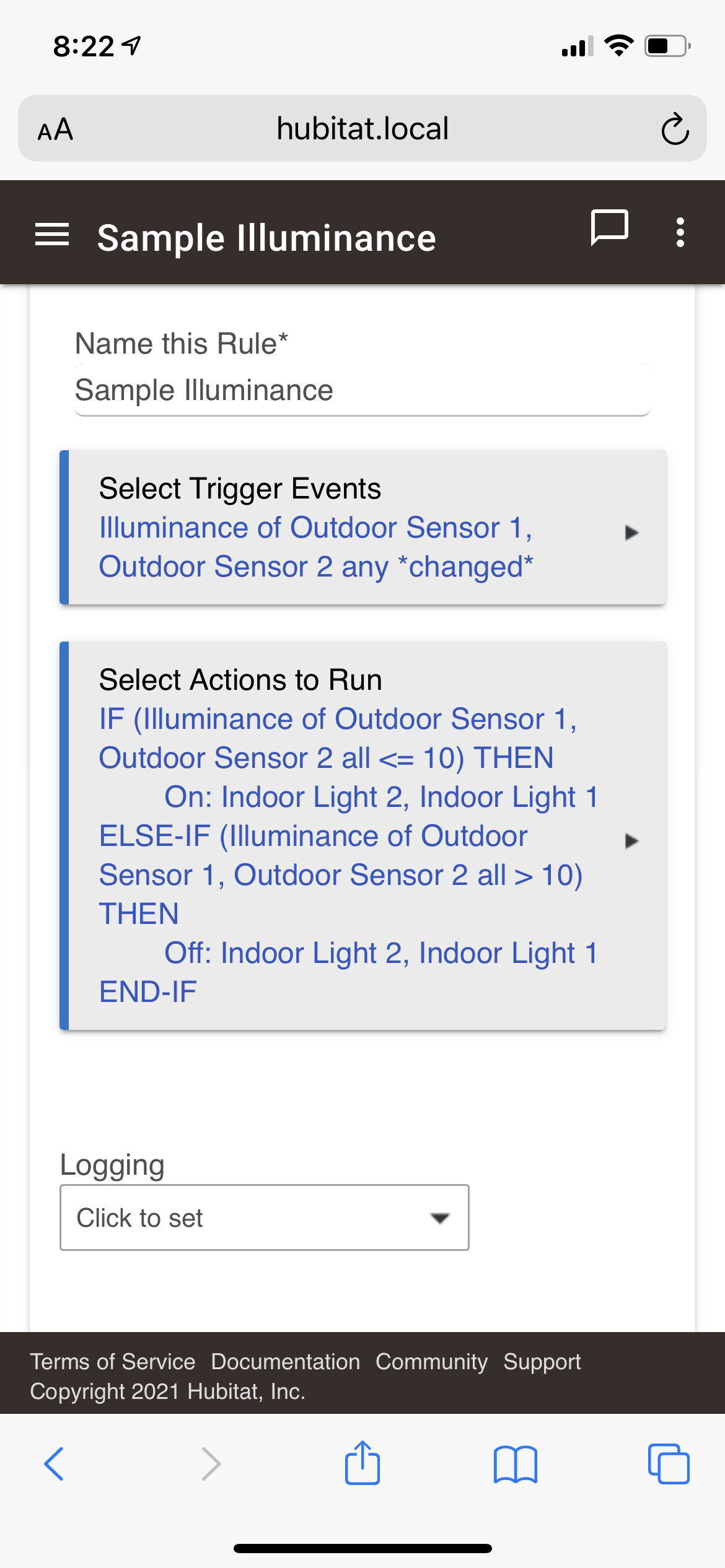

Here is my initial version... ignore the lux values for now, any suggestions on changes to the logic?
Capture1
Not unless your temperature sensors are reporting every 1/2 second or quicker. Most temperature sensors report only when there is a change in temperature, and not frequently at all. This won't present a significant load on the hub.
