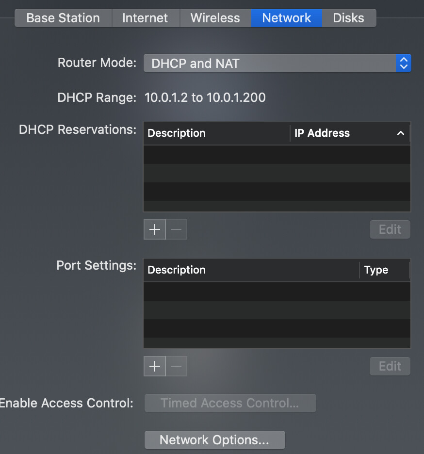

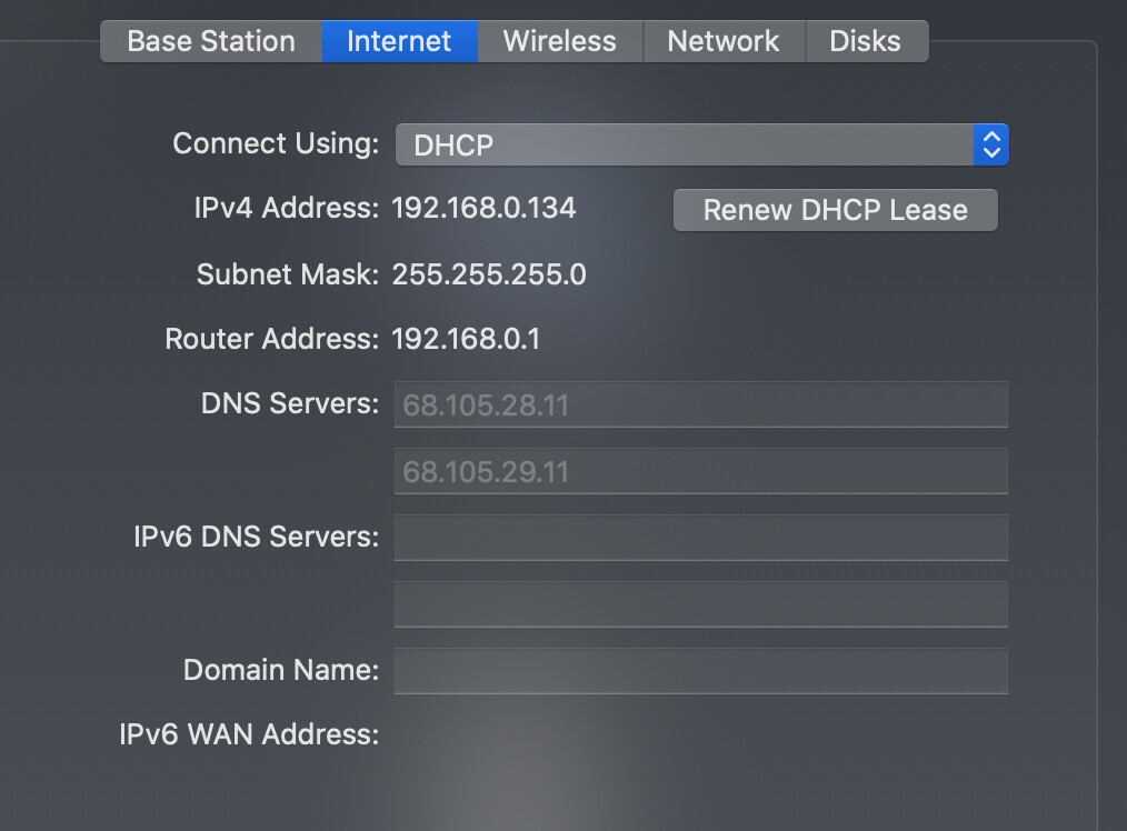

Here are some screen shots below of the set up.. How do I configure such to work?

I believe Router Mode needs to be DHCP only. Otherwise you are double NATting - not usually needed.
You are fine ignoring the double NAT warning, just check the ignore box, as you have done. But make sure that the LAN address isn’t on the same network as the AirPort Extreme’s WAN network to the Cox modem. You’ve got it set up properly, your LAN is 10.0.1.xxx.
Yep, you are on the right screen for the DHCP reservation. Depending on the number of devices you have, and guests, you might want to set a different range for DHCP reservations, such as 10.0.1.100 to 10.0.1.200. That leaves 10.0.1.2 to 10.0.1.199 for guest devices such as iPhones, etc., that come and go (unless you want them always at the same IP).
