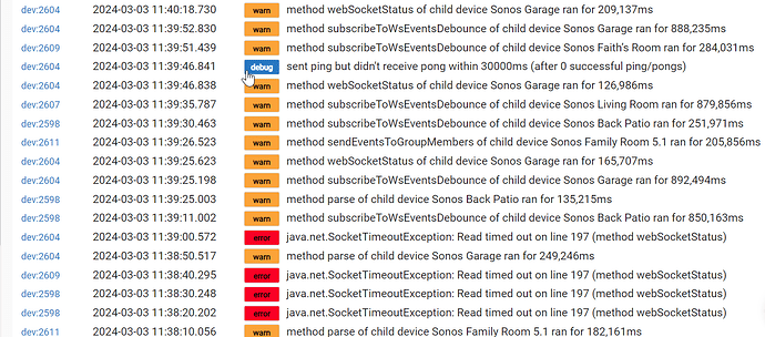

i always get this on start up of the hub
if i disable it and re enable it it will be fine. So its as if the hub starting up makes it do something that runs away
Hmm. I wonder if somehow it’s getting tossed in a loop for a bit. If it’s not too much bother, could you turn on all logging, debug and trace level, then send me the first minute or two worth of logs from a speaker that’s going haywire? There’s a bunch of cooldowns already in the code that should keep it from going too crazy, but maybe there’s someway that it’s not getting limited properly.
Than said every reboot on my hub causes a huge spike of activity, from a ton of stuff not just Sonos Advanced. Though Sonos Advanced is certainly the heaviest thing causing the spike. Initialize() does a ton of stuff so having it run for every speaker at once is definitely going to cause a big spike.

I'm getting severe hub load alerts again on the latest version. Just noticed none of my sensors were turning on lights around the house, attempted to access HE and it was unresponsive. Unplugged power and restarted HE and within 2 minutes the device page hit 360% total with my 5 Sonos speakers on ~20% each and a severe load alert. Disabling the 5 speakers made it stable again.
Weirdly there's no warnings/errors in the logs.
