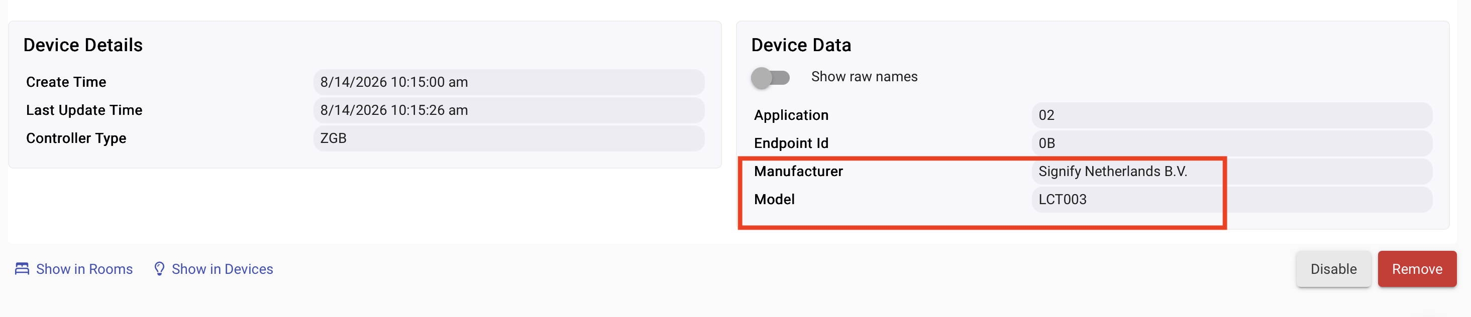

Hello - I have a really strange problem. Recently - an unknown bulb has been popping up every time I got to pair a zigbee device. It claims to be a Hue bulb (see signature below). I have never used Hue bulbs and every time I initiate a zigbee pairing process, this bulb pairs instantly. If I delete it and try and pair a valid device, it shows up again. The only way I can add a legitimate device is by pairing this "ghost" device. Currently, I have left it paired to my hub with the driver set to "device" (that's what it defaults to). Does anyone know what could be happening? And how I can get rid of this thing?

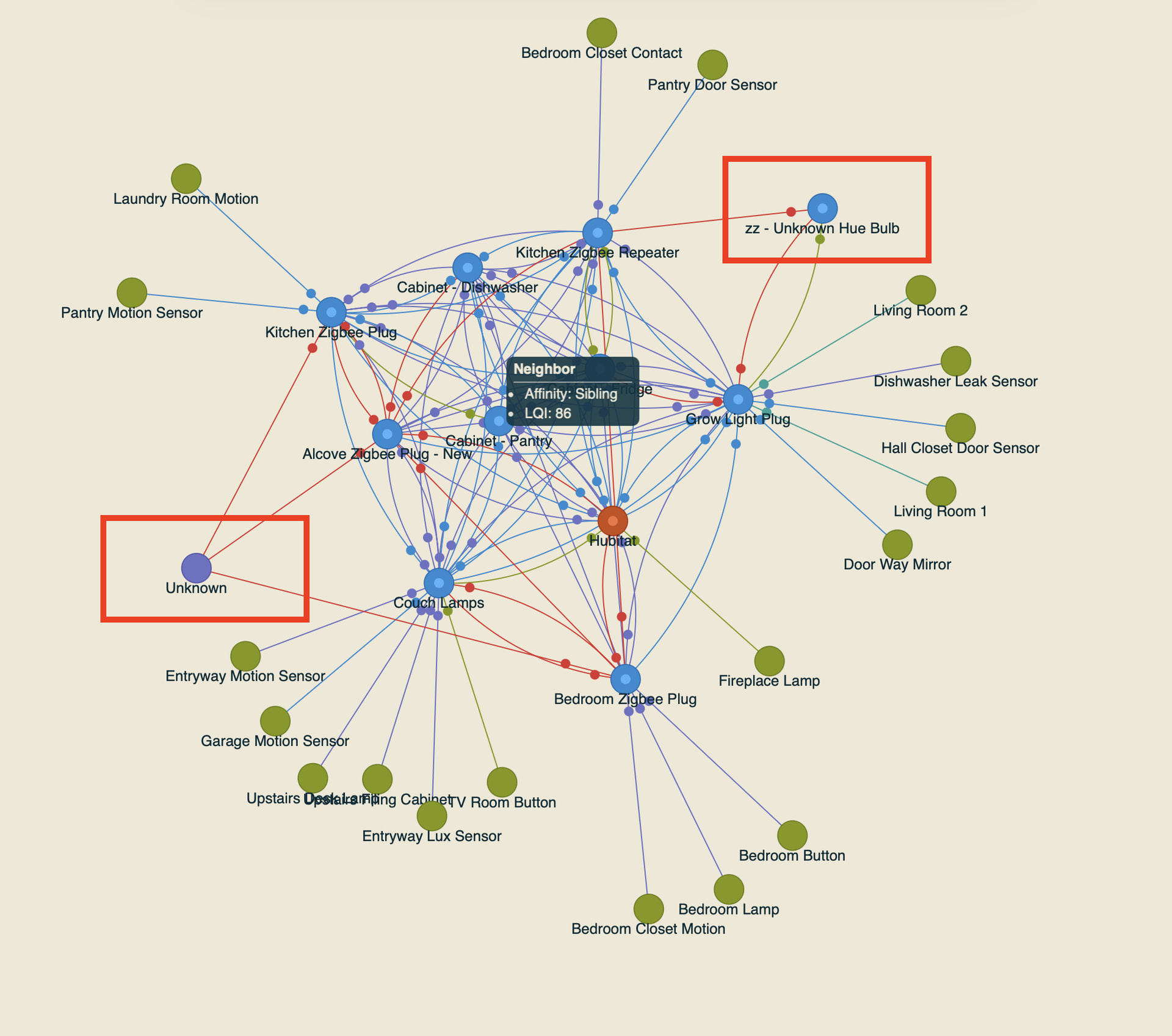

maybe a zigbee map neighbors would help? At least help you see what repeater it's connecting too? or change the driver possibly to a switch and have it toggle on / off /on repeatedly to see if you can identify it that way?
Google says it's a Philips Hue bulb.

This is what the Zigbee map shows (and now there is an "unknown" as well :thinking:). I recently changed zigbee channels (this mysterious device problem was already happening before I changed channels). It is consistently been showing as a "repeater" and connected to the Kitchen Zigbee Repeater (IKEA Repeater) and/or the Glow Light Plug (Samsung Zigbee Plug)

The purple Unknowns are just an artefact of the ZB mesh, most likely when you changed channels.

Nope - I've never had Hue bulbs and haven't added anything recently. I discovered this problem when a couple of my Sengled bulbs started acting flaky (turned out that removing on the the IKEA repeaters that they were routing through fixed that issue) but during that process I had to reset and re-pair one of the bulbs. That's when this mysterious thing started showing up and wouldn't let the Sengled bulb pair. Once I "allowed" this to pair (driver = device) the Sengled bulb paired right away​:man_shrugging:t2:

That also seems unlikely, but I have no other ideas. Hue bulbs should act as repeaters, so it might be interesting to wait and see if something tries to find a route though it. If it starts acting as a repeater, it gives you an idea of where it is based on what devices find it as the best route.
In the Zigbee Map app, it does show as a repeater (blue) so I can only hope that nothing tries to route through it​:crossed_fingers:t3:.

I believe disabling the device only tells Hubitat to ignore it, but the Zigbee mesh doesn't know you disabled it in Hubitat, and it will still act as a repeater if something decides to route through it.
It may be that nothing sees that device as a good route, especially if it is in another house, so probably nothing will try to use it anyway. Hard to say.
