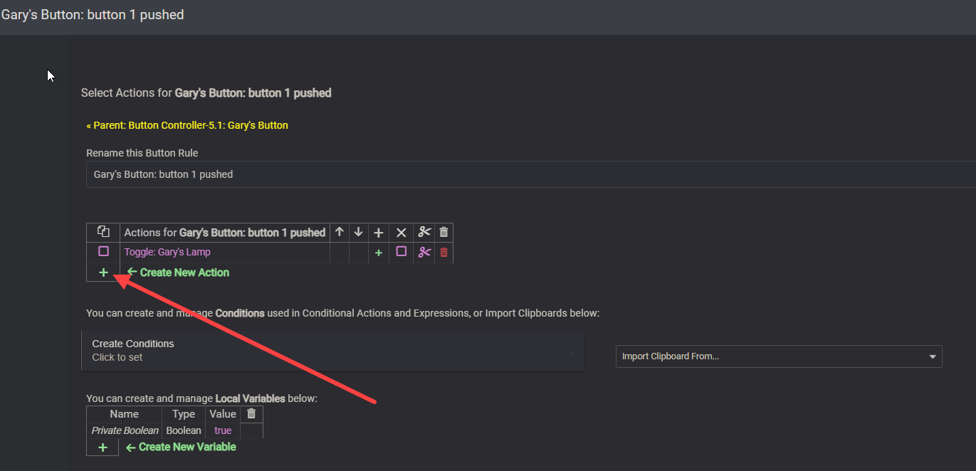

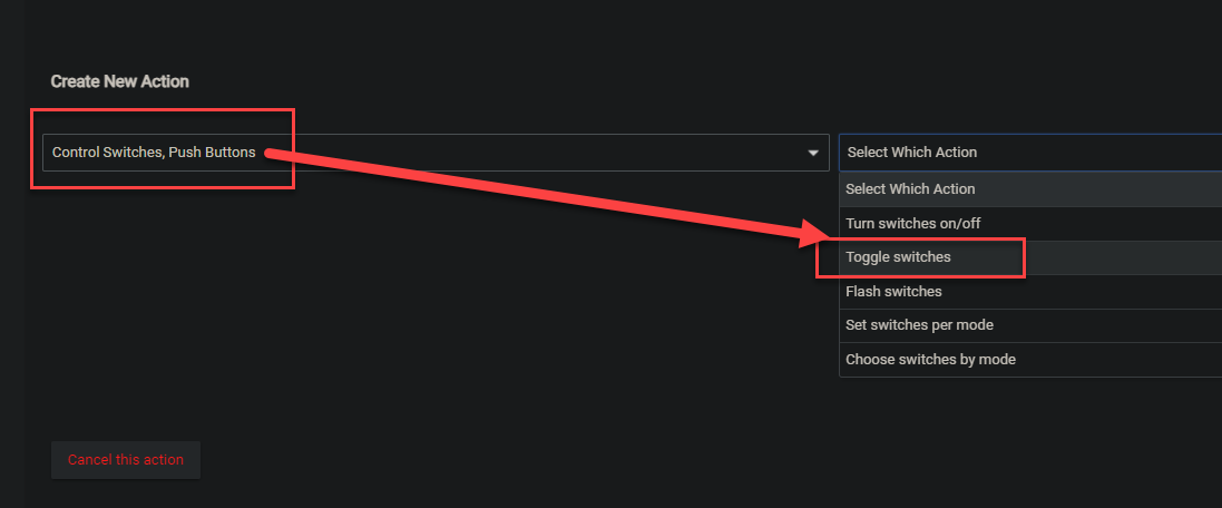

I expect there will be some details in the link @rlithgow1 provided, but you can also look at this option when creating an action.
I've never seen the Create New Action panel. Got a link?
After you create your rule and give it a name, click on the Actions section:
Then Create New Action:

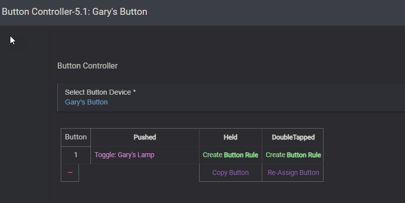

To add. Here's a very simple way to make a button press/push toggle your switch using button controller.
You select your button/remote from the button devices. Then it'll generate a grid with all the actions your button can do. Such as Pushed, Held, DoubleTapped for my button.
You select create button rule for Pushed. It'll bring you to the actions page for the Pushed command you'd like to program.

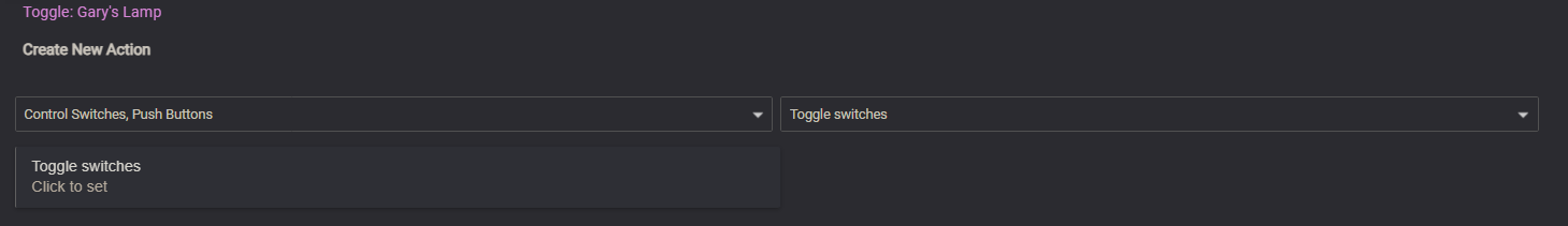

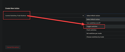

Then you select control switches and selection Toggle switches, then select your switch.
