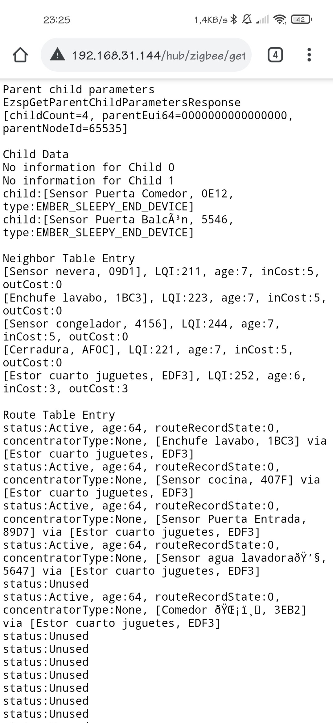

  1. Can you post the output of the endpoint "/hub/zigbee/getChildAndRouteInfo" as a screenshot?

You have 5 repeaters. Of the five, the only work that is being used as a repeater is
"Estor cuarto juguetes". The other repeaters have an outCost of 0, which is not good. What are those other 4 devices?
Edit: Bottom-line - the zigbee mesh needs some strengthening.

I am seeing that many of my devices do not come out, such as the motion sensors aqara or the xiaomi, I have one xiaomi and 4 aqara, nor the xiaomi button, why do they not appear in that image?
THey have either dropped, or are connected more than one hop away from the Hubitat.

The output of that log in your screenshot can only show zigbee devices.

Take a look at the LQI numbers for each of your repeaters. The only one that is working as a repeater has an LQI over 250. The maximum is 255, so that repeater has a strong connection. The other ones are significantly less.

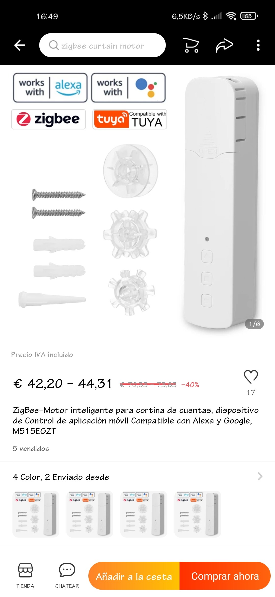

From the list of devices you provides, nearly everything is a battery powered Aqara/Xiaomi sensors that do not have repeating capability. There are also a couple of Itead Sonoff sensors, that would not be Your blinds appear to be based on Tuya Zemismart technology. Since they have motors, they are likely to be mains powered and so might function as repeaters. Since my eWeLink plugs are also based on Tuya technology, I am hoping the blinds are compatible repeaters for Aqara/Xiaomi.
Hopefully, another compatible repeating device will be sufficient, but do not be surprised if more than one is needed.

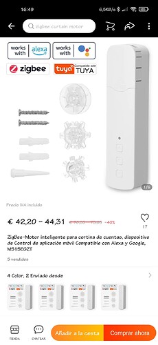

here I give you a photo of the device zemismart blind. "Estor cuarto juguetes"

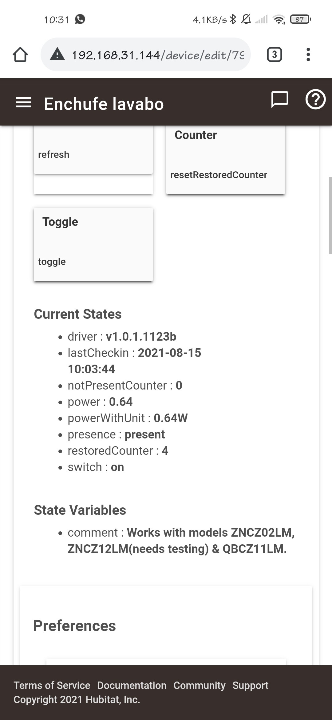

I am waiting for a plug to arrive, ikea, since I have read that it works very well from repeater, from what I see "enchufe lavabo" is a xiaomi zigbee plug, pro it does not act as a bridge, so I will remove it from he, that do you suggest me?

I’m not sure if the xiaomi plug you use is ever functional as a repeater in a Hubitat zigbee mesh; according to your screenshot above, it’s definitely not acting as a functional repeater in your mesh.
The zemismart blinds you’re using do appear to be repeating.
