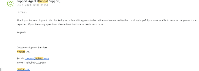

EDIT 2: Im very glad the support Team reached me about this issue and they even went beyond my problem checking in advance my hub was online already!
EDIT: Hopefully it works now! I realized the hub was connected via USB to one of those USB ports of my wall electric multiconnector (bad practice, i know). Now its using a dedicated power adapter with a new USB Cable as recommended.
