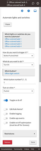

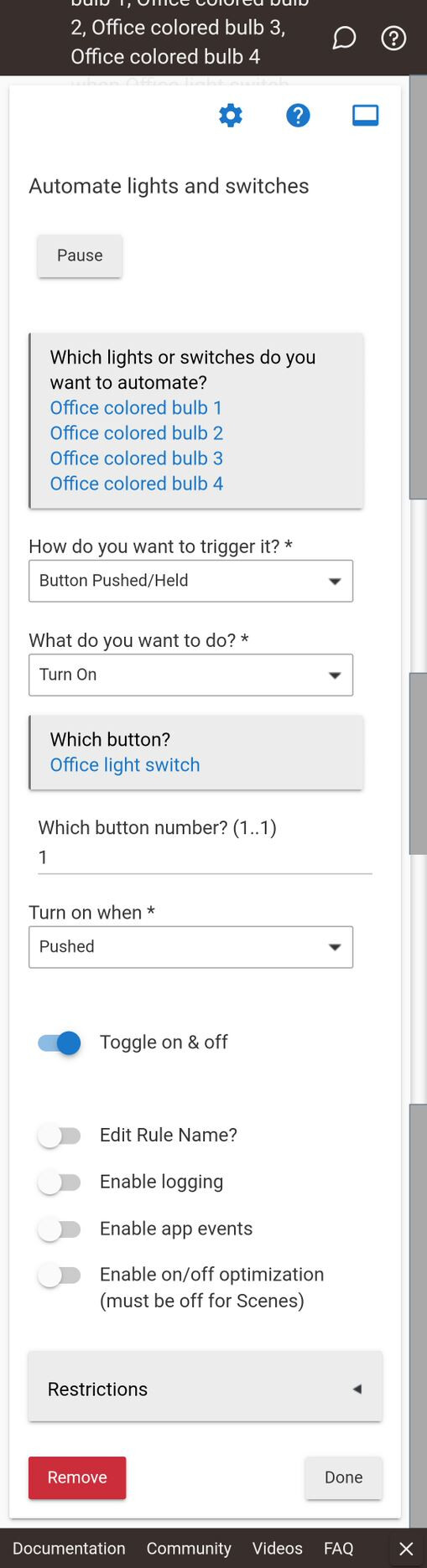

My Lutron Aurora Controller ( Button )
is what I have been using for the last few years to turn on and off the light bulbs in my office.
Using Simple Automation Rule 1.1
  • I have four light bulbs selected to automate
  • Button Pushed/Held as the trigger
  • my Lutron button was selected as the button
  • button 1
  • pushed - turn on when
  • I have the Toggle on & off selected
this worked for years...
now the toggle on & off does not work
And I have created a virtual button to see if it makes any difference... And no the toggle feature still doesn't work.

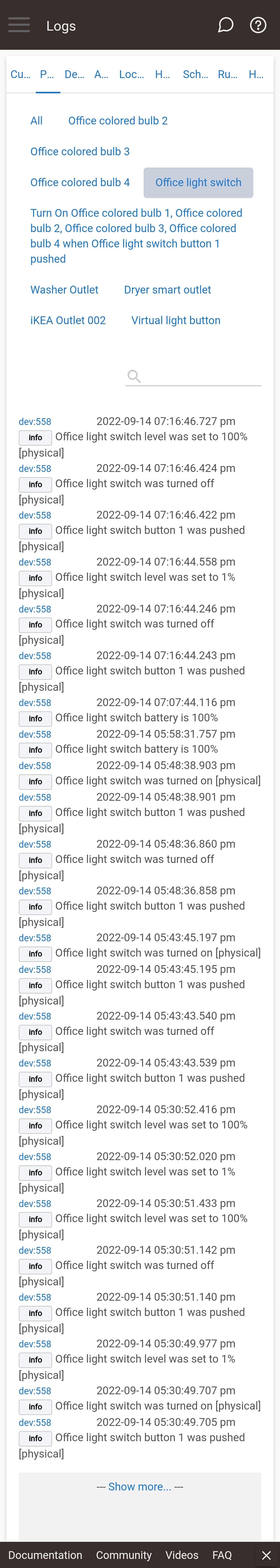

Have you tried to enable logging and see what the logs have to say?
It stopped working within the couple weeks I guess as I was out of town and I just noticed that it didn't work today. And it did work a couple weeks ago.
Yes I can control the device's from the device page.
When I toggle off the toggle on & off feature and press the button. If the lights are off it'll turn them on and vice versa. But the second button press does nothing.

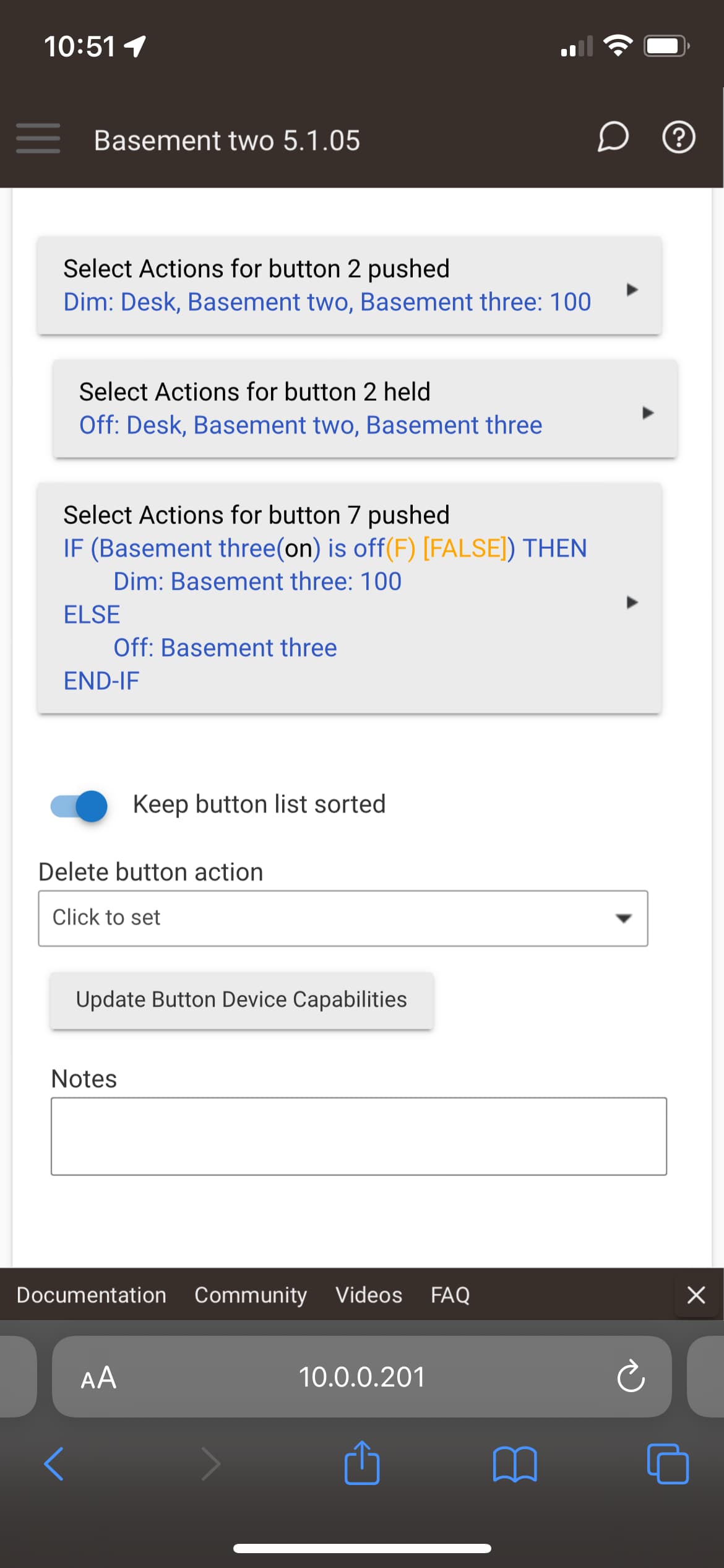

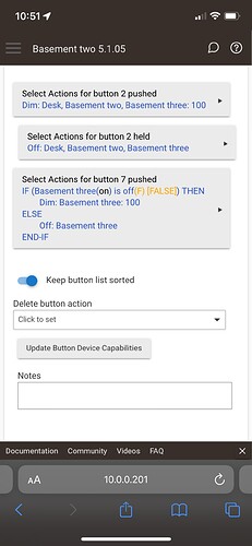

I just started having this issue with four sengled bulbs that I have in a group. It appears that the bulbs are getting a low dim level before they get turned off so the toggle was returning them to a low state.
Might not be the issue in your case, but it looks like your is toggling on to 1%. I just rewrote my button controller for button # 7 today replacing the toggle with this.
