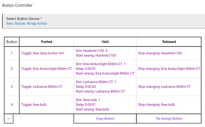

For both controllers, I set them to use 1 button to toggle/dim each lamp using a button controller i HE.

When starting level change (up), Hue bulb starts at last on-level, and so I start with a command to set dimmer to 0. Otherwise no issues.
The IKEA bulb will not start raising from off, so I must start with a command to set dimmer to 1. (Also means Room Lighting app will not work, as it simply sets a level).

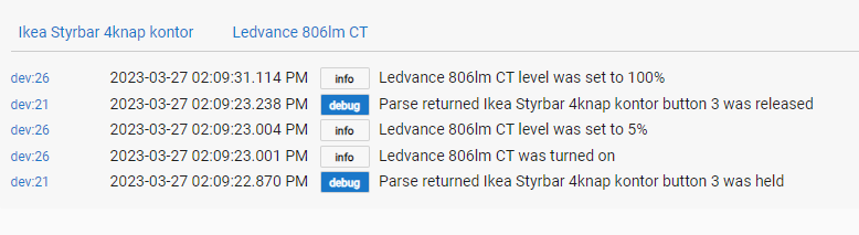

One of the odd behaviours - Going to 100% after stopping at 5%.
