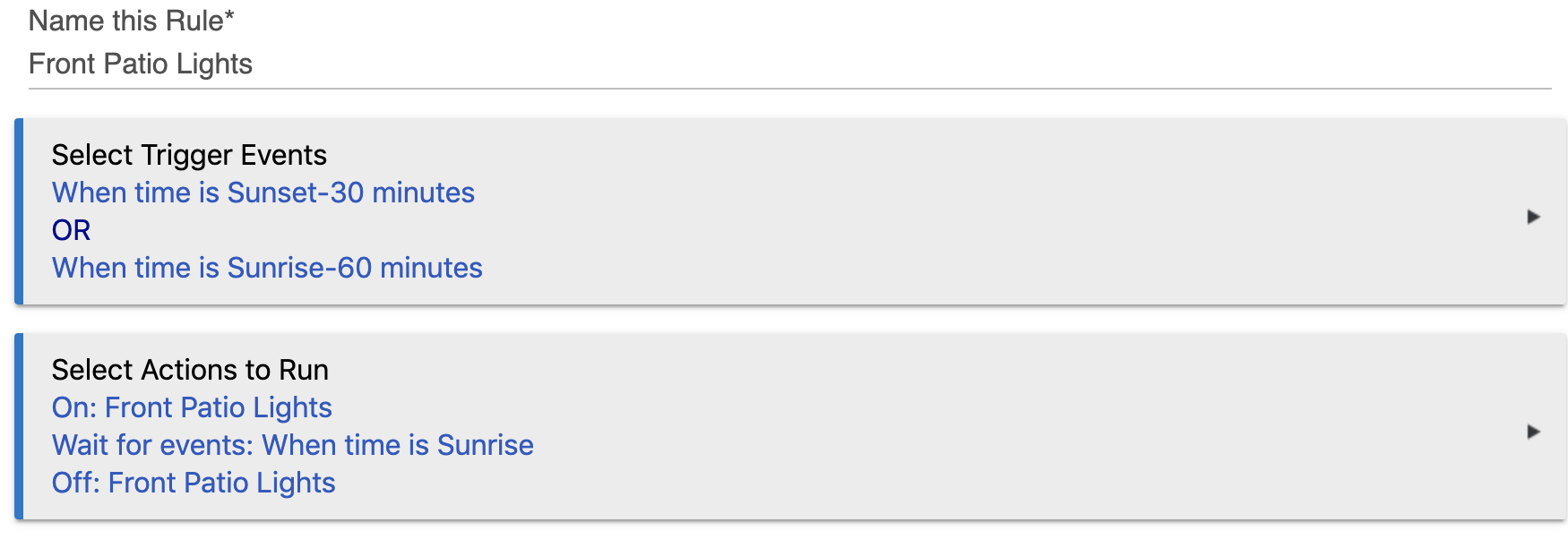

I created a rule to turn my light on before sunset and before sunrise, then I have a wait event to turn off at 11:30pm, but also tried adding await event to turn off at sunrise. When I add a new wait event it overrides the existing. Can I not have multiples?

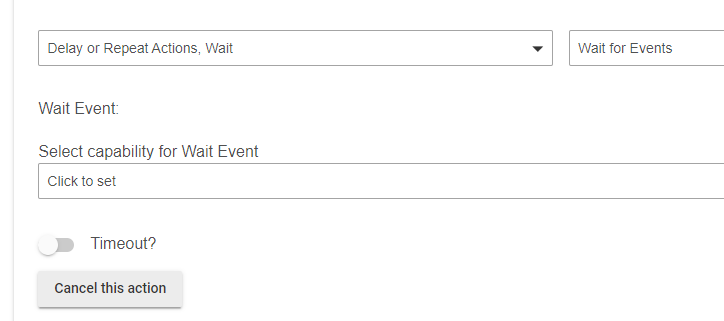

Okay....let's go through it set by step. Add your wait event. You get this.
Now add your first event.

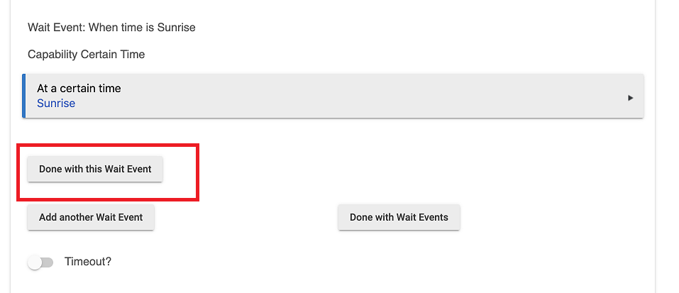

Click done with this wait event. Then you get this:
Click add another wait event. Then do the same thing again.
Then click done with this wait event and then done with wait events. The key is using the "Add Another Wait Event" button.

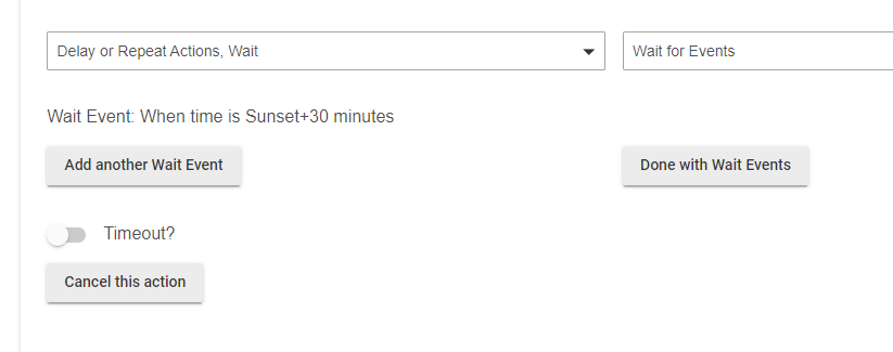

Here is the first wait event:
Then I click "done with this..." and "add another..."
and it removes the previous one.

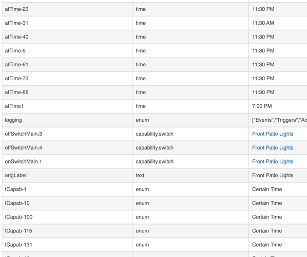

Looking at the properties of my rule (which was a child/clone) of another rule seemed odd. Lot's of repetitive settings. I've created a new rule from scratch and it allowed me to create with multiple events. Bug?
Then you will see the button for add another wait event. I suspect you are clicking Done with wait events, which is the wrong button.

That is the button I was clicking on, and as soon as I did it erased the previous event. Creating a new rule works fine and I could edit it just fine too. I think my rule was somehow corrupt.
