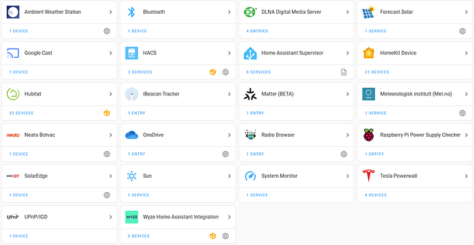

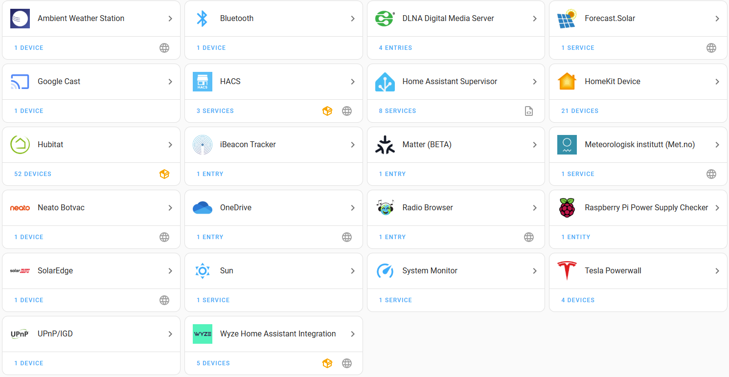

As I said, I primarily use HA for local integration of Ecobee devices and some Aqara FP2 sensors via the HomeKit emulation. Those I export back to HE via HADB. I also use the Hubitat integration to pull devices from HE into HA via the Hubitat integration (only to use in HA dashboards for some easy graphing).
I also have some other integrations on in HA, but they really aren't actively used.
(that is the cloud Ambient integration, because I have the local integration pushing to HE).

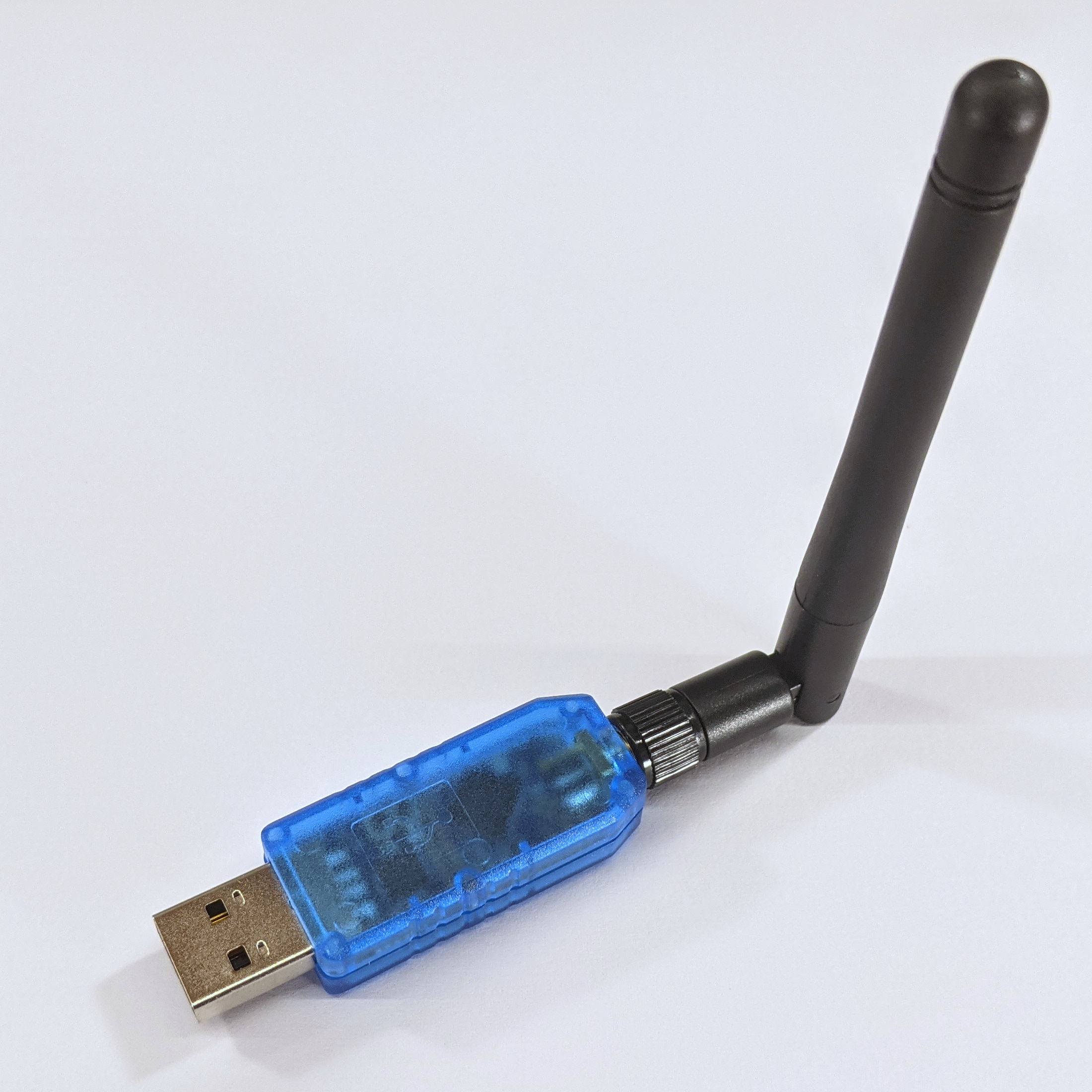

FWIW, this is the dongle that I've used with z2m for 4+ years.
I use a couple Sonoff Dongle-P as routers.

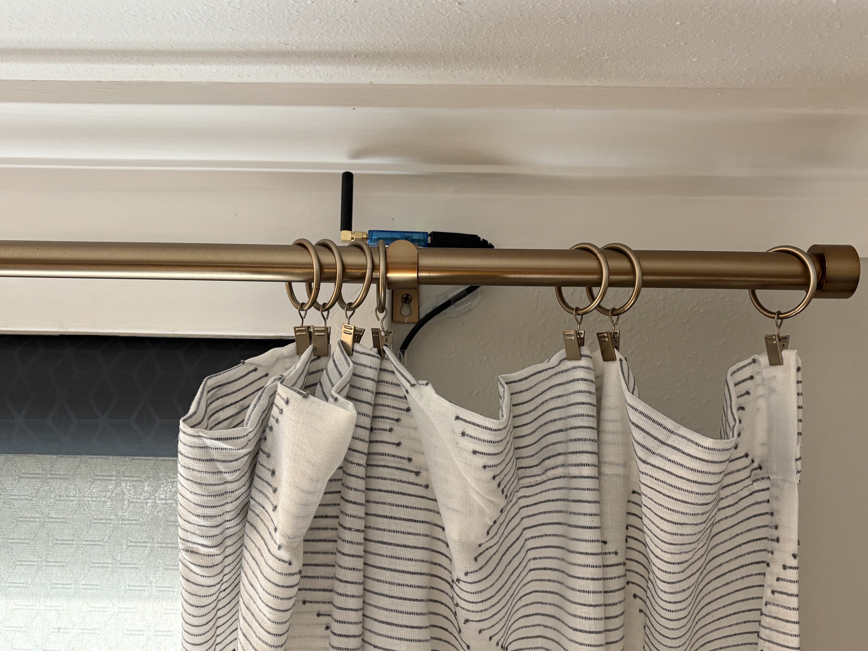

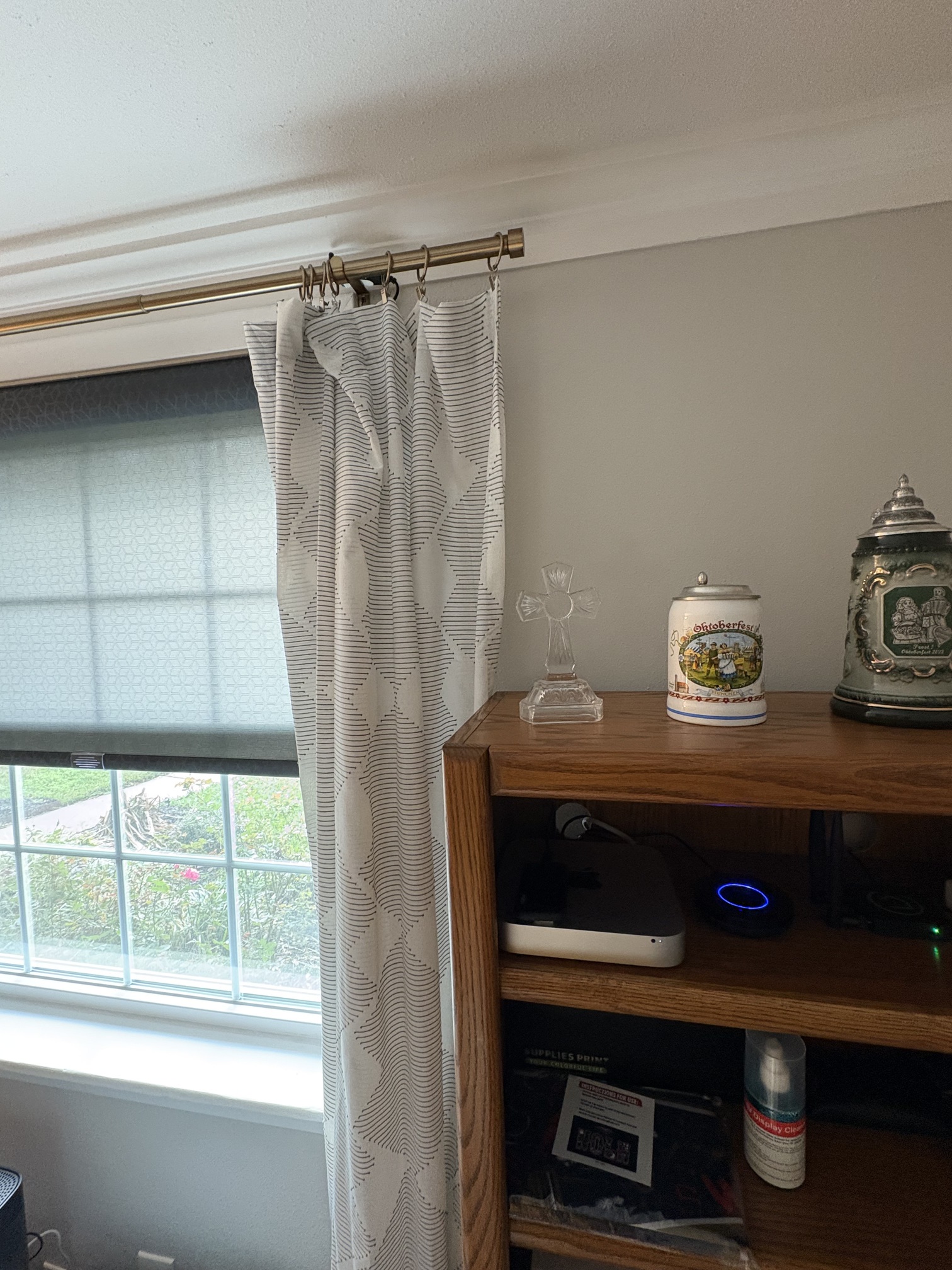

This is my setup - everything is on a really old Intel Mac-mini, the USB cable for the dongle is hidden behind the curtain, and the dongle is mounted on top.
That is the same chipset in the Dongle Plus I believe. Thank you for the info.
Similar. I think Dongle-P uses a slightly newer chipset. Anyway, the secret to a stable zigbee mesh with any coordinator is having lots of robust zigbee routers. I like to have 1 device capable of routing for every 3-4 devices (routing/end combined).
My larger zigbee mesh currently has 71 total devices, of which 21 can work as routers/repeaters. So that's a ratio of 1:3.4. It has been extremely stable. The other advantage of multiple routers is that it really extended battery life. I have devices that are running on the same battery for 3 years .....

Steins are for drinking, not displaying. :wink:
Wait, or is it both. I dunno - too many beers.
