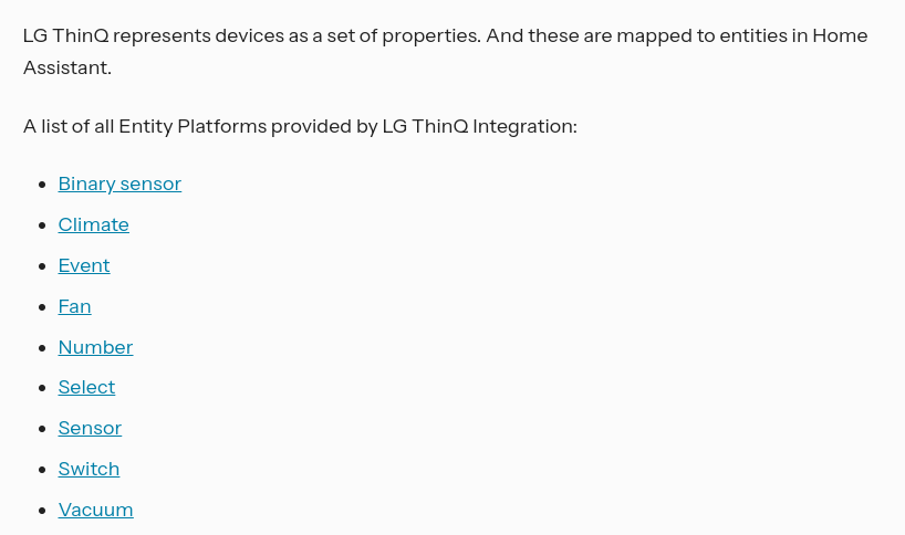

From LG integration on HA:
These are all supported by HADB

One can imagine a case of wanting to use the washer or the dryer at off peak hours when energy cost is lower and nobody is on site to start it. Since all entities of LG integration are supported by HADB, no helper are needed on HA side.

There are no such thing as combined sensor and switch entity. Both are from different domain.
As shown in a previous post, the LG integration does not use button entities.
