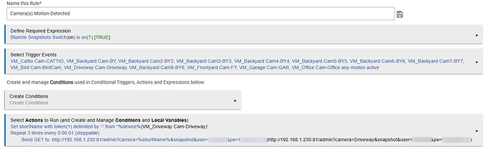

I have a simple rule (shown below) with several motion sensors. The actions contain a (5 X) Repeat loop. My question is, what happens if the actions loops is being executed and another device/motion event is triggered? Is the new event(s) queued until the current actions have been completed?
(image shows a 3X repeat loop, revised rule has 5X)

Your rule actually doesn't have any repeats/loops. :slight_smile:
If that was your intent, you need an END-REP at the end, or otherwise need to construct it in such a way that the "Repeat..." and "END-REP" lines surround the actions you want to repeat.
(EDIT: Apparently, it will indeed infer the END-REP if one isn't reached before your actions just end, but like END-IF, this is not technically proper and is not a habit I would get into.)
Looks like 3x? (EDIT: Also nevermind, missed the above...)
As for the core of the question, the above response is correct--nothing stops this sort of "overlap" inherently, so you'll need some approach like that to address it if it is a concern for your automation.
Note my last statement enclosed in () The image I posted was from a previous version.
FYI, as for END-REP, my rule works as it is and assuming no overlapping events executes the Send GET 5 x. My guess is that it works because there is only one action below the Repeat. Similar to a simple If statement needing no End If. That said, probably a good idea to add the end-rep anyways in case I add more lines
