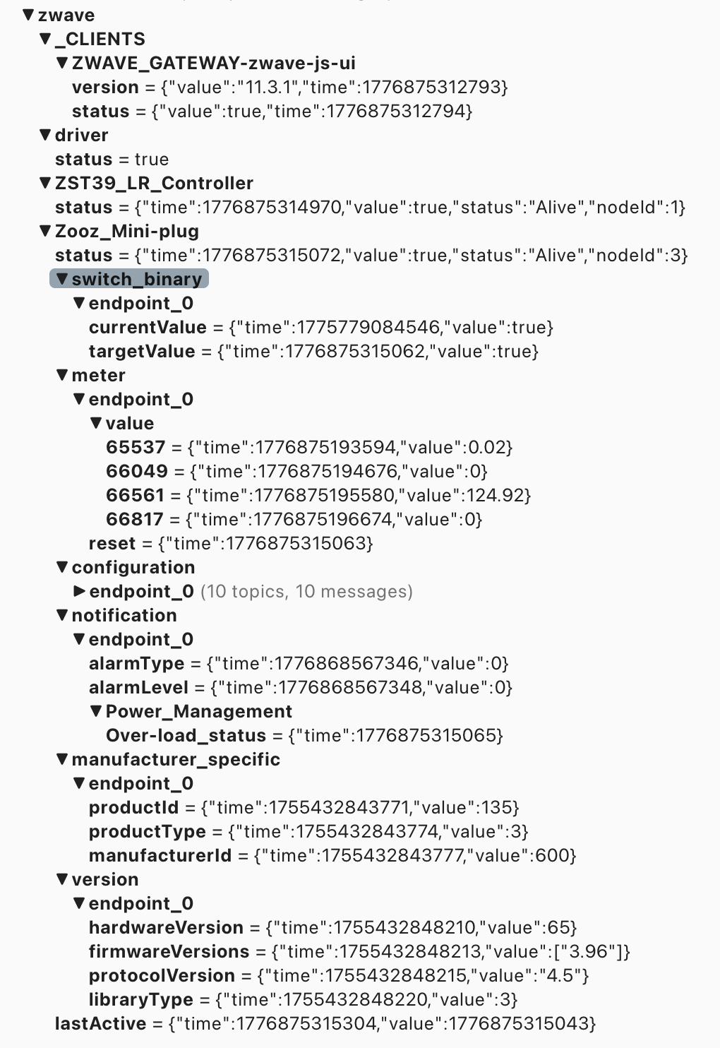

It kinda works with bringing in devices using ZwaveJS. I can see status changes, but am unable to control devices. This is what one of my ZWaveJS devices looks like:
Any chance of getting a ZWaveJS importer like the zigbee2mqtt importer?

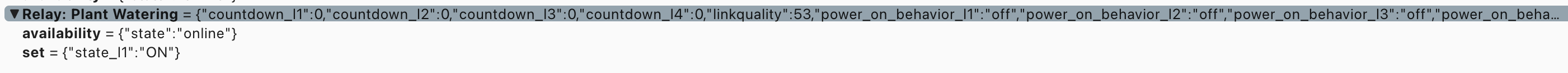

Multi-endpoint switch with four endpoints and temperature sensor:
{"countdown_l1":0,"countdown_l2":0,"countdown_l3":0,"countdown_l4":0,"linkquality":53,"power_on_behavior_l1":"off","power_on_behavior_l2":"off","power_on_behavior_l3":"off","power_on_behavior_l4":"off","state_l1":"ON","state_l2":"OFF","state_l3":"OFF","state_l4":"OFF","temperature":25.8}

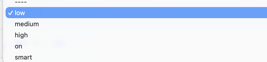

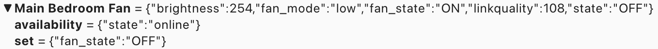

Zigbee Fan Module (Hampton Bay):
{"brightness":254,"fan_mode":"low","fan_state":"ON","linkquality":108,"state":"OFF"}
Supported fan modes are:

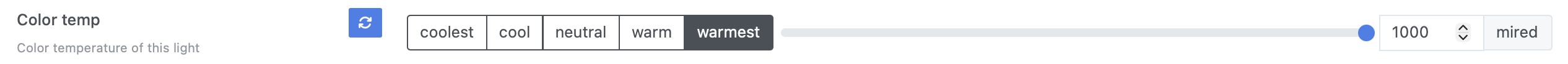

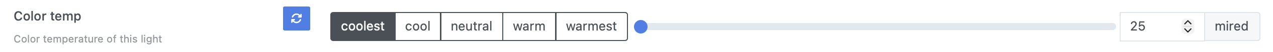

Tuya RGB/CT light
{"brightness":254,"color":{"hue":349,"saturation":31,"x":0.3627,"y":0.3175},"color_mode":"hs","color_temp":244,"color_temp_startup":25,"linkquality":0,"power_on_behavior":"previous","state":"OFF"}
Color temp goes from 25-1000, withj 25 being coolest and 1000 being warmest.
CT issue should be fixed in 2.5.0.123, which was released to the public ~ an hour ago.
I did the "best effort" fix on the fan, but I don't have a real device to test it on. So, maybe fixed.

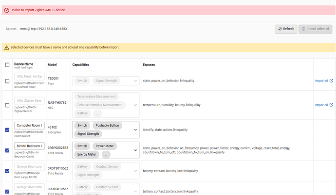

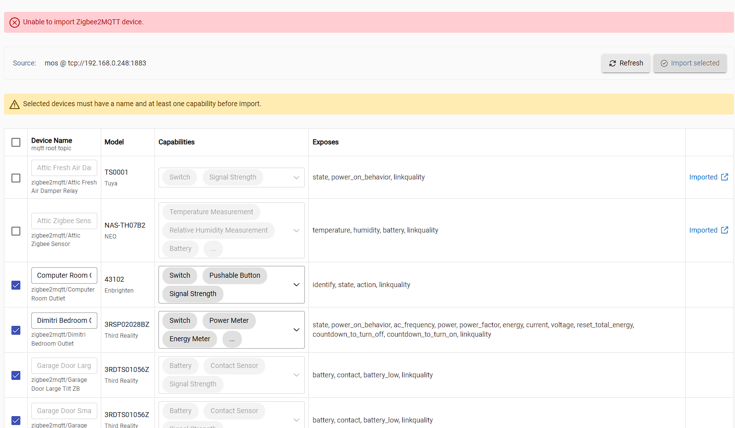

Just FYI @gopher.ny that any time I try to import multiple zigbee2mqtt devices it gives an error, and only imports one of them.
Importing the same devices one at a time works fine.
EDIT: I have found if I just keep the same selection list and do the Import Selected over and over they eventually all add. Sometimes one device each round, sometimes more.

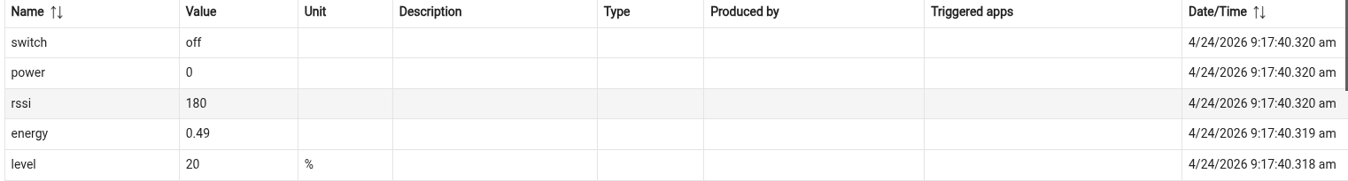

@gopher.ny Also, you may need to think through what should be a state change and what shouldn't.
For instance, zigbee2mqtt that integrates with home assistant has this option enabled in zigbee2mqtt:
MQTT message payload will contain all attributes, not only changed ones. Has to be true when integrating via Home Assistant (Default: true)
Because of that, on every update all attributes are included. Which is generating a â– â– â– â–  ton of extra events on the hubitat side for attributes that did not change.
For example on this Inovelli Blue dimmer connected to zigbee2mqtt I get 5 events every update, even though only 1 attribute changed:
