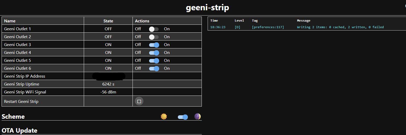

I’m pretty sure i’m missing something but it seems I have to add a command topic/device and a corresponding state/device topic. I just learned how to ttl the CB3S module in my TUYA power strip (Geeni GN-SW008-101) it’s just been collecting dust since I ditched all TUYA (until I started flashing) devices. I have it up and running with espHOME web server had to use ltchiptools to flash the UART initially. Sometimes I think there is little to NO information of how the MQTT Import/Export can be used so again, I assume I’m missing something.
Screenshot 2026-07-28 182211

I am not a sw engineer and my comment is not a real help. Recently I built a complex DIY Device using MQTT protocol with multiple attributes (relays, contacts, temp sensors). Homeassistant had no problem to pick it up correctly. Hubitat also picked up right everything but I was not able to map anything at all. It happens to be Hubitat does not support MQTT Devices with multiple attributes. So, I ended up with custom driver. Your device also has multiple attributes and this is a problem with current Hubitat MQTT mapping implementation. But I could be wrong.
