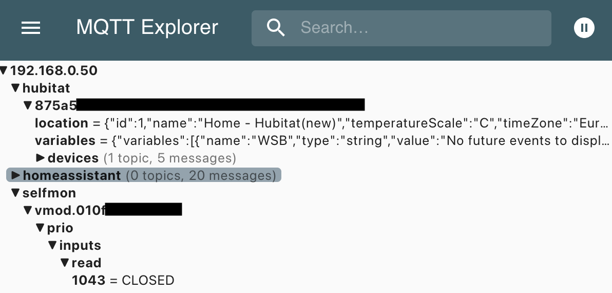

With the new MQTT broker functionality in the latest version I'd like to bypass the Pi and node-red if possible. I've got the broker running on Hubitat and if I use MQTT Explorer I can see the topics being updated from my alarm. So what's the best way to use that topics change to actually change the virtual device state. Example here from one of the doors monitored by my alarm closing:
selfmon/vmod.010***/prio/inputs/read/1043
Do I need a to make a custom driver that maps each topics message to the individual Hubitat virtual device or is something already available to do that? TIA
