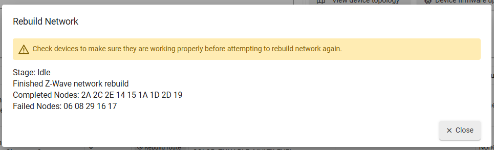

I have a 4 zwave relays ( Zen 52s that i use for lamp control and to strengthen the mesh) and in my last place these would respond almost instantaneously when i pressed the zen 37 remote. In my new place, there is a fairly noticeable lag from press to relay activate, and in many cases the relay doesn’t receive the command. I checked the logs, when i press the remote - the action is registered - its not the remote. When i ran a zwave rebuild network, I'm getting multiple failed nodes. My knowledge about how to try and fix this is very limited so would greatly appreciate any thoughts and I can only assume that this is part of the lag issue I'm having with my zen 52s.)

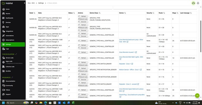

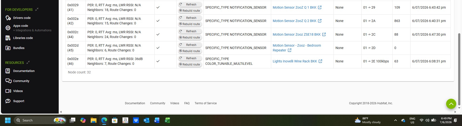

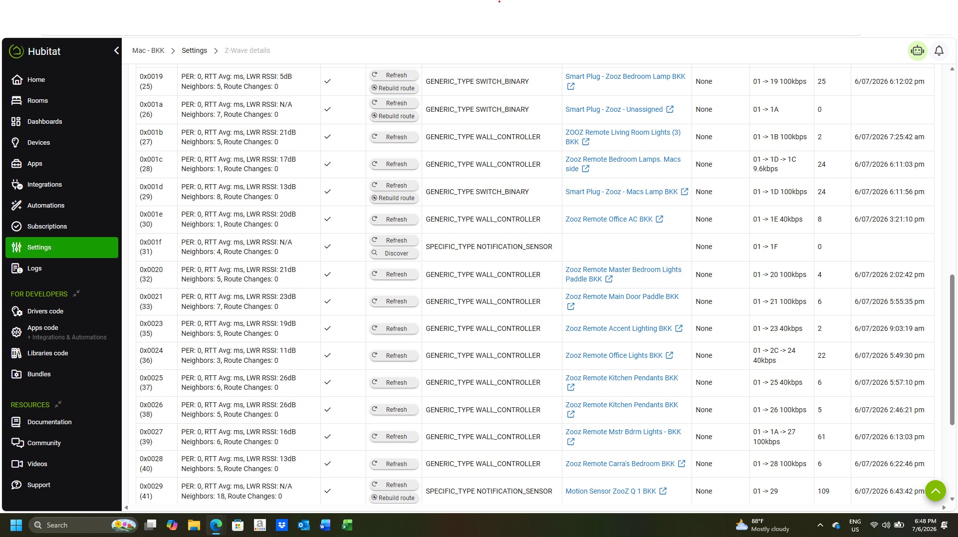

I suspect that the force deletes have left "ghost" devices on your mesh. If you screenshot and post your Zwave Details page(s) we can probably tell you which ones need to be failed and removed.
Appreciate the help. Here are the devices
