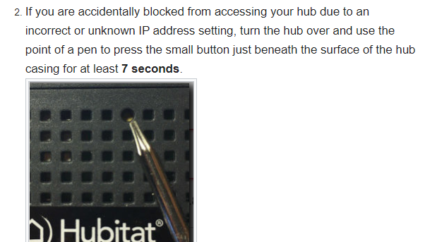

Hi All,
Hoping for a simple answer here.
Im fairly new to hubitat, bought c7 last year after my SmartThings hub was retired.
I've slowly been building out a half dozen smart switches, laundry / garage.
Anyways in the last 8weeks i moved to a new house, had a newborn join our family and in all of that I never made a backup of my hubitat.
As we're settling in to the new house I was trying to get the hub back running but I cannot log in to it. Trying to access the old IP or using hubitat.local and it doesn't respond.
Trying to Find My Hub, I can only see it via MAC search where it shows me the old 192.168.1.208 ip address.
The new router is based on 192.168.40.x
I've read a few threads about unplugging the ethernet port while its booted and it should get a new IP address however I'm not seeing anything show there.
The new router is super limited and while I can see it connected it does not show me its IP address even though I have a green light on the hub.
Any suggestions ?
You probably need to get it back on DHCP, see note 2 in this section:
https://docs.hubitat.com/index.php?title=Network_Setup#DHCP_address
