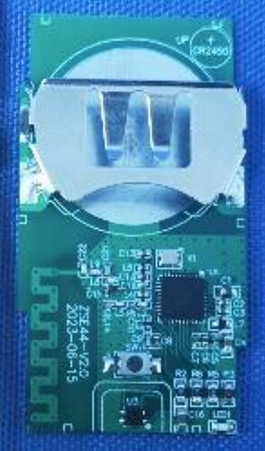

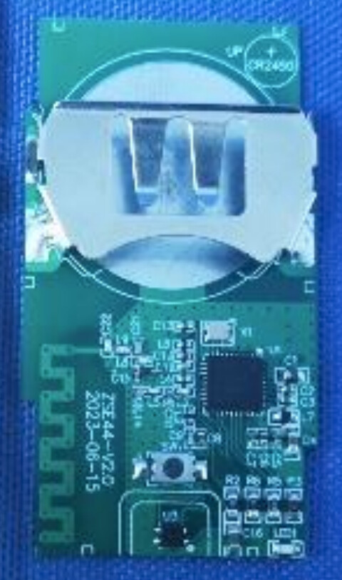

However, I have a handful of Zooz ZSE44 temperature sensors. I have 8 total, and out of those 3 of them have had the button on the circuit board fall off. The button is placed very poorly imo and it happened for each of them when replacing the battery. The button is right below the battery and you have to use something to push the battery up from the bottom to get it out. But with the button missing, there is no way to perform a zwave include/exclude or factory reset.

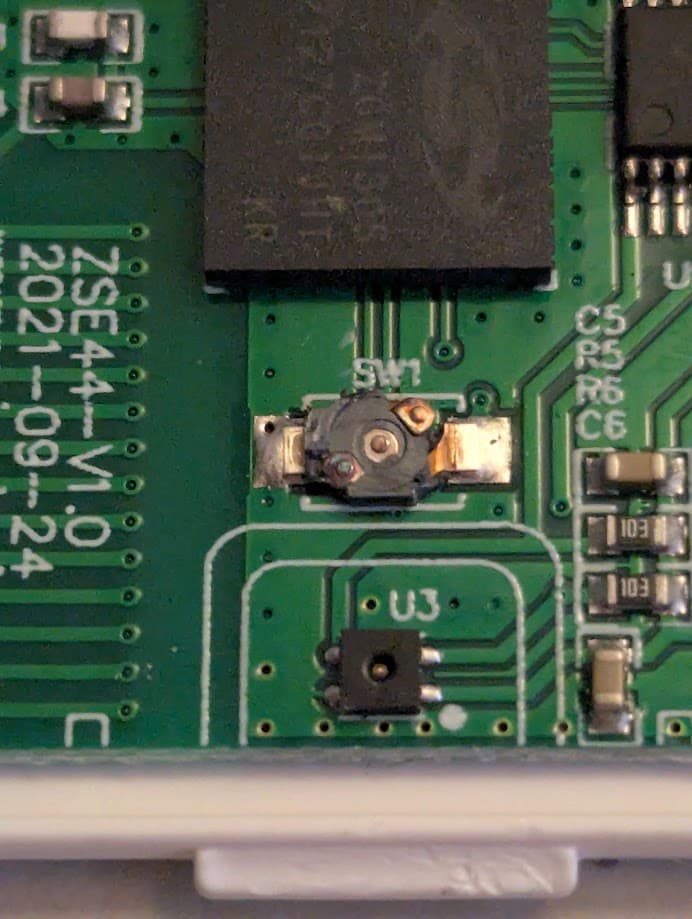

No, I did it by mistake when replacing the battery. The coin battery fits really tight into the holder and I used a small plastic stick (a spudger) to push the battery out, but because of the tight fit, even when pressing as gently as I can, the battery sort of pops out suddenly and I wasn't prepared for this and my hand slipped and the spudger scraped against the button which popped it off. I know the way I originally worded it made it sound like they just randomly fell off, but I was trying to not draw attention to how they came off, but just the fact they are missing.
IMHO, bad design and the button shouldn't be so ready to pop off
I just tried using a paperclip that was unbent so that the two ends are just the right distance to the pads and it worked.

EDIT: Well, shorting the pads seemed to have worked once but I can't seem to replicate it and I'm not sure why...

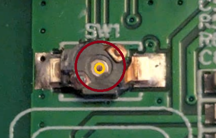

Got my multimeter out... The pad on the left has continuity to the metal in the very center of where the button was. The pad on the right has continuity to the little dot in the top right of where the button was. The left and right pad do not have continuity. The two metal dots under the button do not have continuity. So I thought what I needed to do was short the two small dots under the button, but that seems to not do anything.
I am not sure how to simulate a button press. I did it once by accident and the blue light blinked and the logs in HE shows it woke up.
I would suspect that there was some sort of spring metal that would connect the outer (red circle) contacts with the inner (yellow circle).
The surface of those contacts might need a little cleaning. :thinking:
