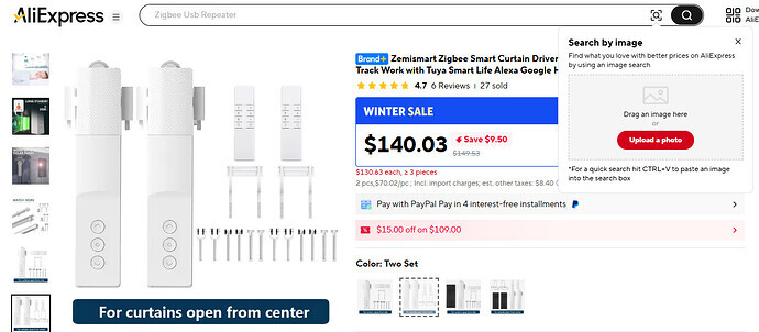

I was doing some research on motorized curtains. I’d like to get a kit that includes the motor and track. I’m only seeing 2 options here that have both. Zemismart and Aquara. Are either of these natively compatible with HE and do they connect directly or require an additional hub.
Thanks in advance.

I've had good luck with the ZemiSmart curtain openers and the community driver.
Battery life has been good, they stay connected and never fail to open/close.
Edit: I combined them into one device with an app/driver combo, based on the community driver, if you end up going ZemiSmart. It is very handy to have them act like one shade device for automations.

Appreciate the information. Is it a direct connect to Hubitat or a Tuya hub required?
Thanks.
Mac
They are zigbee devices that can pair to the hub and work with a community driver.
