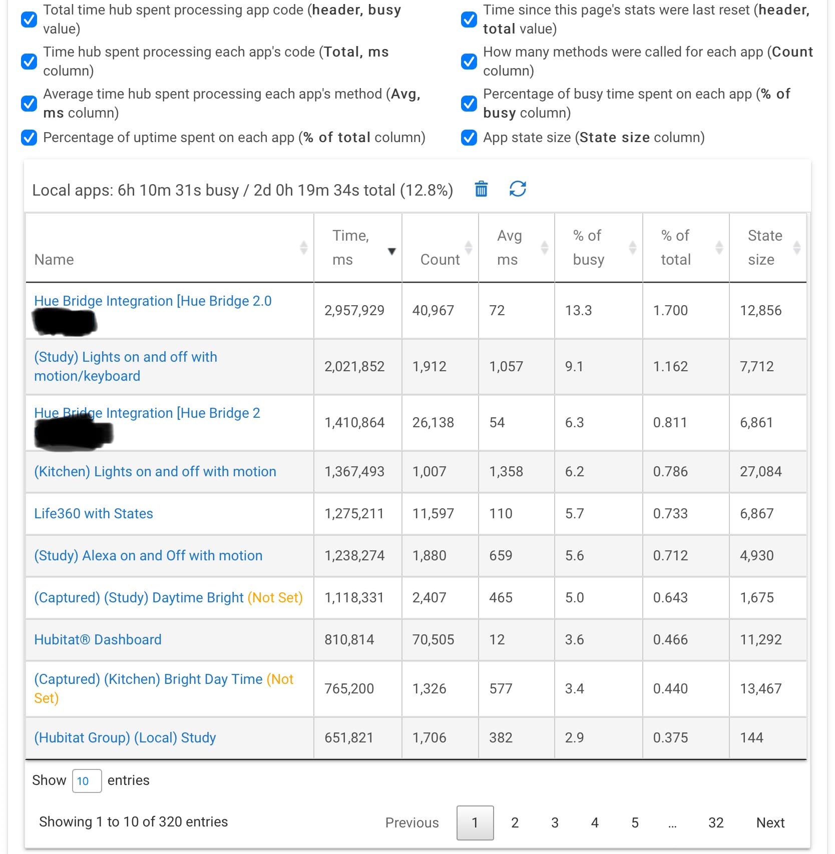

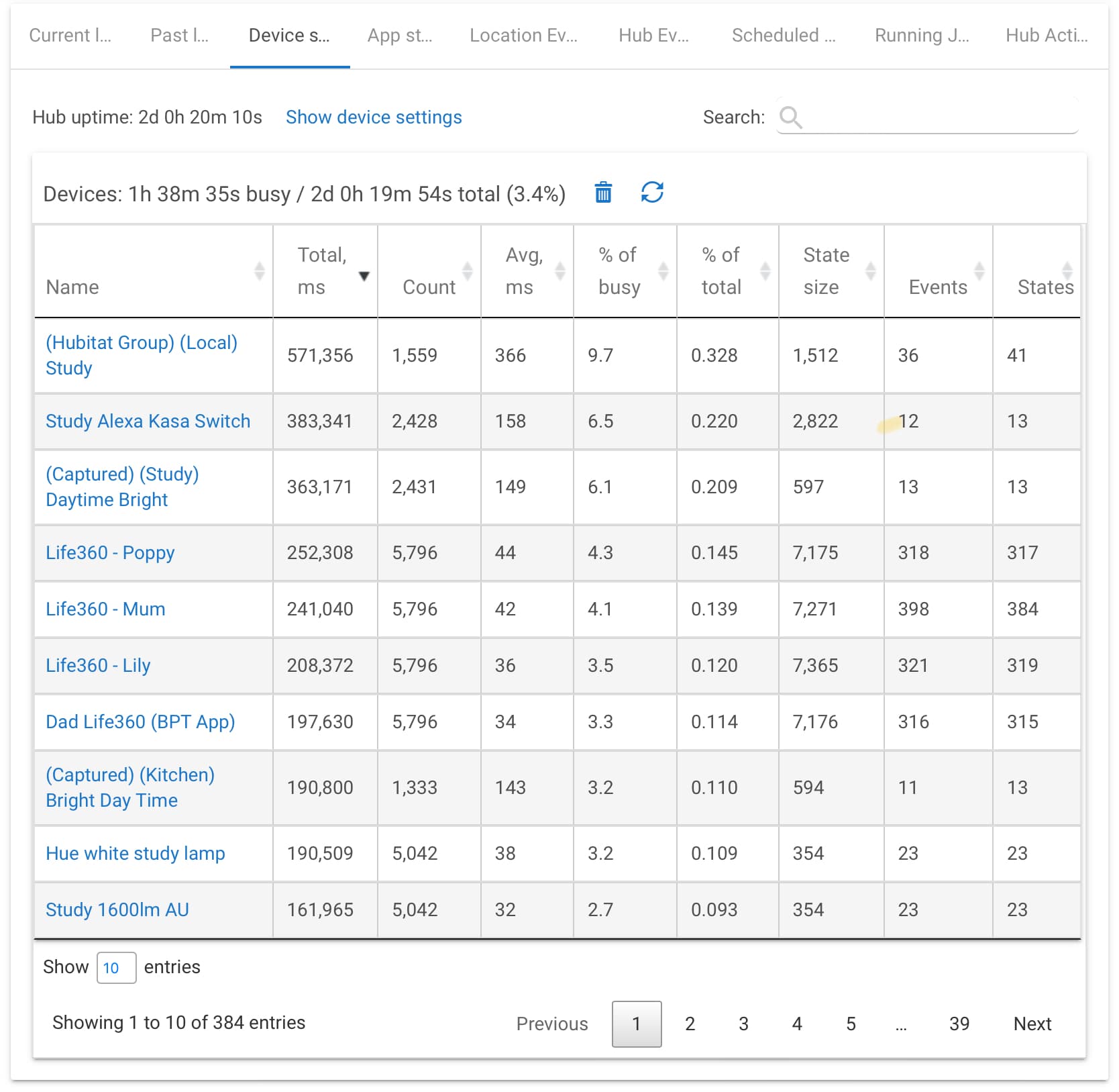

I’ve posted by device and app settings from the logs below (not sure if that sheds light on anything). I’ve also checked the scheduled events and nothing there is showing any excessive scheduled events for a particular device or app.

To me, that App percentage of busy time looks high.
Those states are pretty high. Is there any reason you need to store hundreds upon hundreds of L360 states? Could you trim those back a bit?
And I would say that there is something going on with Hue app, and L360 app, that usage look very excessive compared to what I am used to seeing, but admittedly I don't have these exact apps on my Hubitat.
Same with "Study Lights with Keyboard", what is that, and why is it's usage so high up? Are you polling something or doing excessive refreshes?

Checking my device list, I have 362 devices made up of a combination of virtual and physical. I’m not sure how to generate a list to work out which is which. But it looks to be approx as follow:
Wifi
80 to 90 or so Hue Lights (spread over 2 bridges)
25 Kasa Smart switches (running old version of the community Kasa App pre cloud integration)
7 Wemo Smart switches
2 Harmony Smart Hubs
Broadlink Hub and an IR Blaster
Fronius Solar System.
Also out iPhones (4) connect via wifi as presence sensors.
LAN
Not many here. Just two hue hubs, and a Rachio Sprinkler
The rest are Zigbee, virtual, and Zwave.

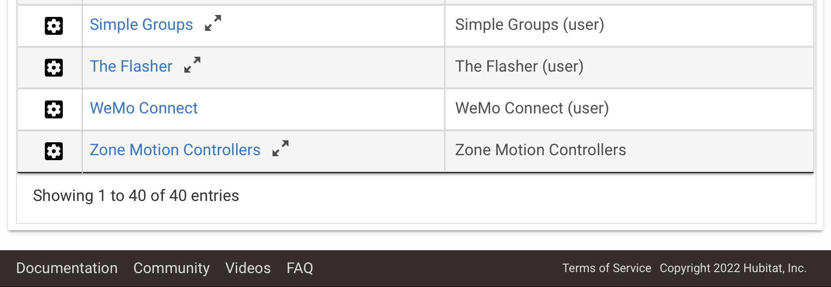

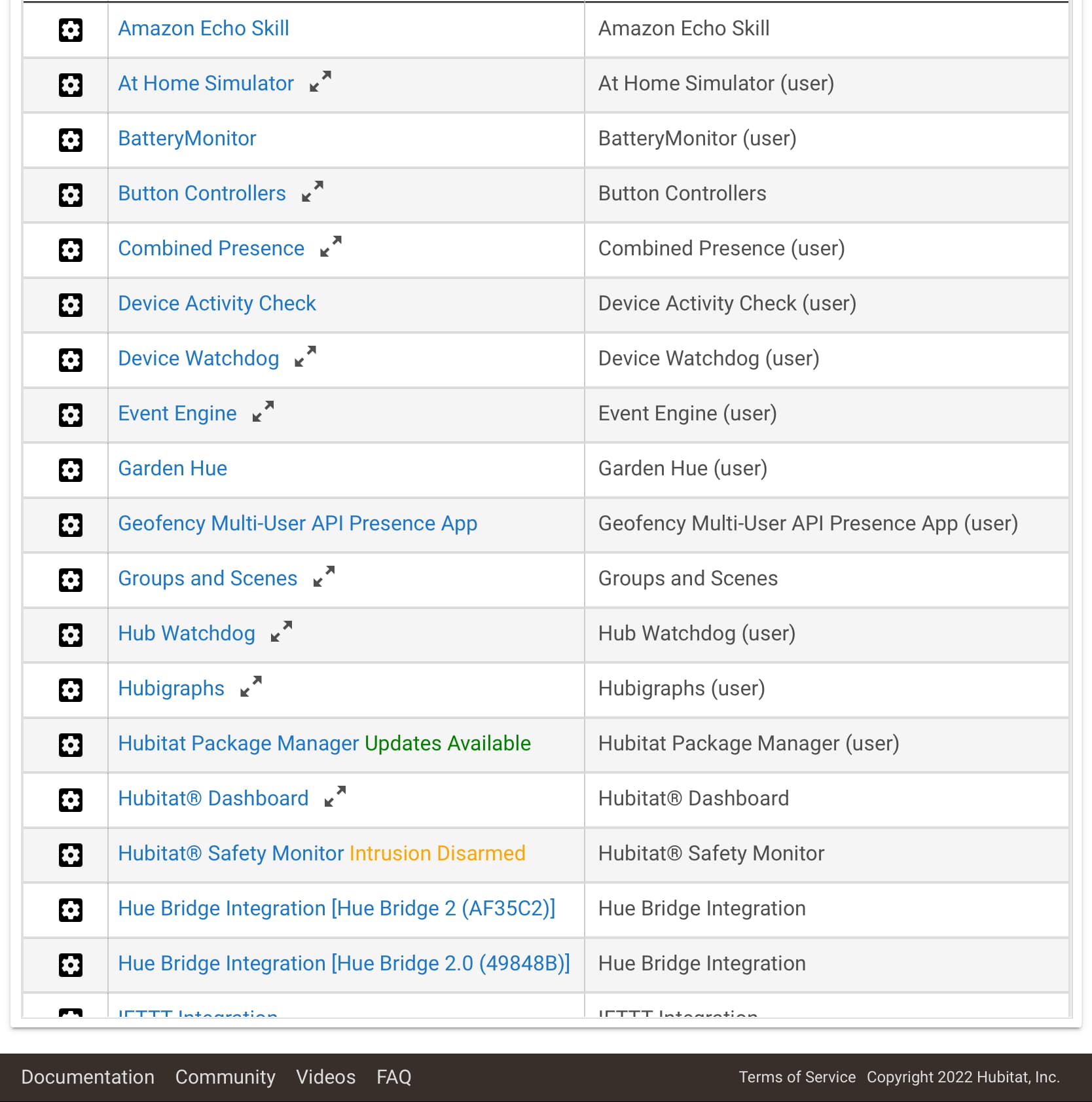

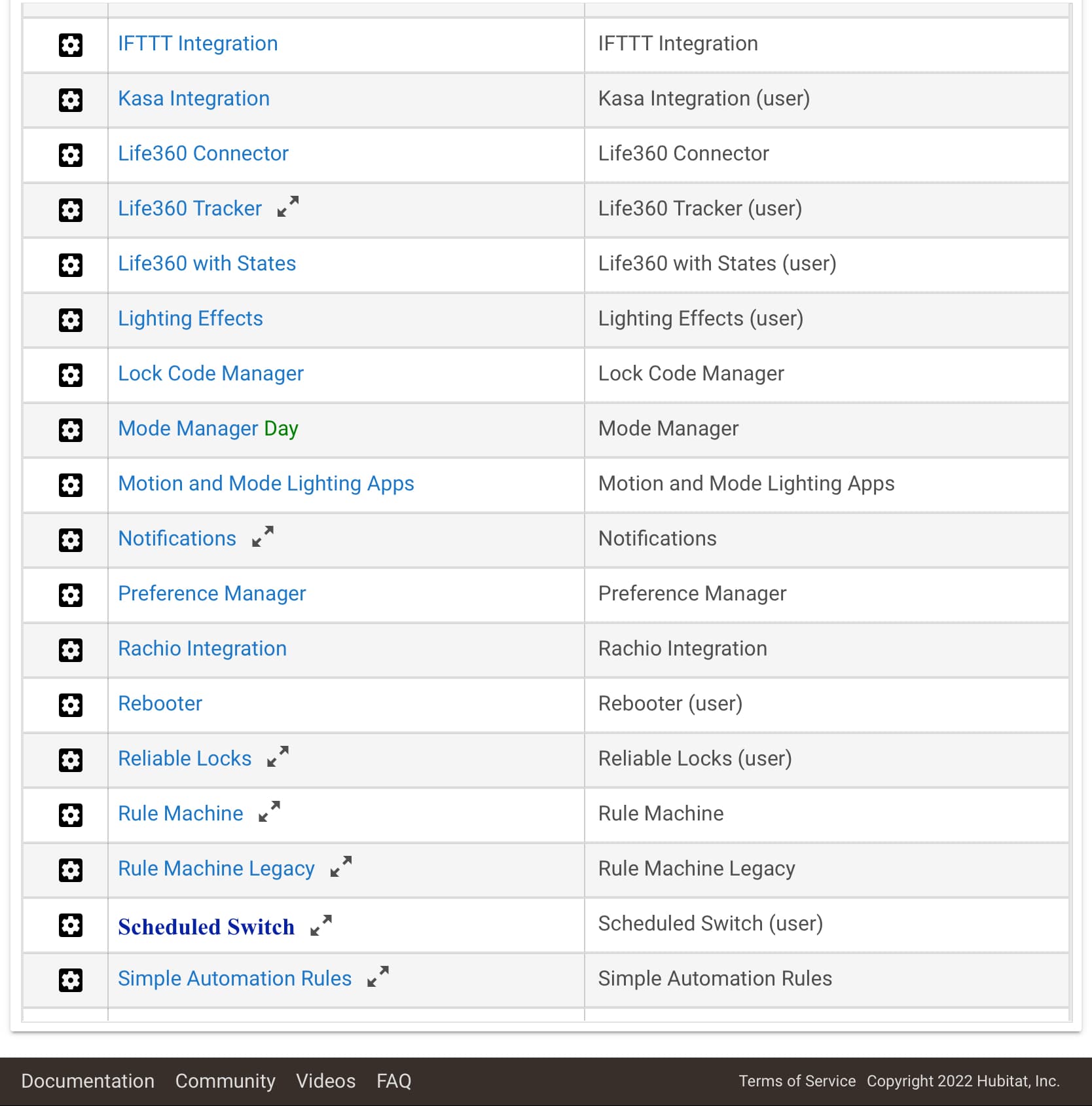

Looking at my app list, 8 I think. My app list is below:
It may be I have this set incorrectly but can’t see where. However I have all my devices across the hub set to only store 11 events including the devices from the Life360 States App.

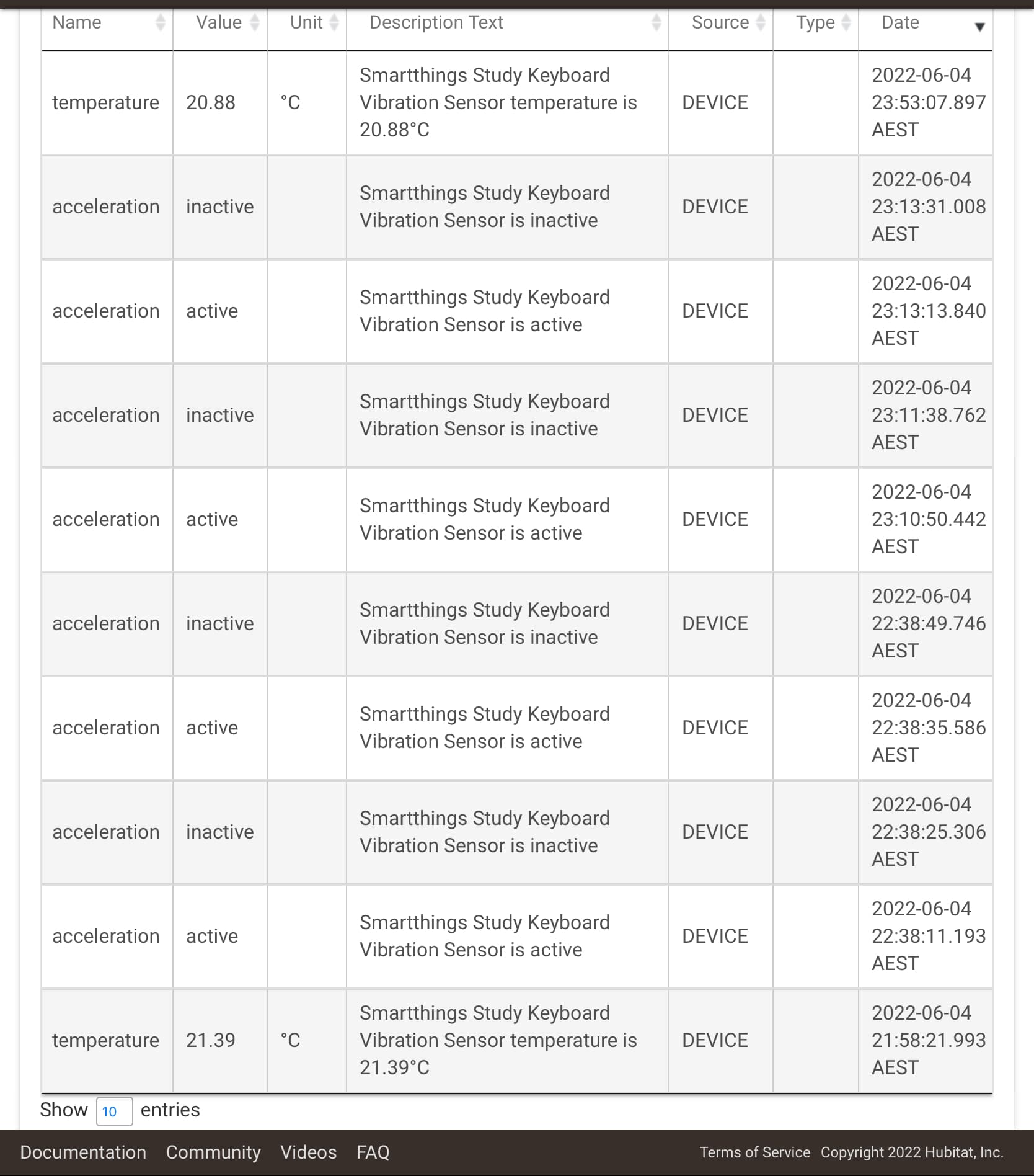

I have an app running in RM to detect presence in the Study so as to turn on and off the lights. The triggers are a motion sensor and a Samsung Multipurpose Sensor. The Samsung sensor is stuck underneath the keyboard and detects when the keyboard is being used as “active” so the rule knows not to turn off the lights even if I am sitting still. Originally I did have the sensor set to record 3 axis as well which completely flooded the hub with events. So that is turned off and only records active/not active. Looking at the event list it doesn’t seem to be triggering excessive events when in use.
The rule I use with it is below:
@gopher.ny I will PM my hub ID.
Thanks everyone again for the assistance with this.
I would have to put some thought into that Study Light rule and how to fix it (or defer to someone like @bertabcd1234) , but triggering on "change" for both of these is probably not the best thing to do. This rule is going to be running excessively due to those triggers. I almost think you need to split that up into two rules, one to decode the logic of presence, and then run this rule from that other logic rule.
I don't use L360, but I know others do, hopefully someone more familiar can give more specific advice. However what I do with many of these "chatty" things like weather and presence is to set the states as low as possible, in some cases 1 state. Unless you really need to go back in history, there isn't a reason to store so many. There used to be a lower limit of 11 before the hub would excessively do a cleanup process, but that was fixed a while back so you can safely reduce those states below 11.
Again I don't use Hue Bridge, but those look like they are storing excessive states. I am not sure who the expert with Hue is, but hopefully someone sees this and can make some suggestions about taming these a bit.

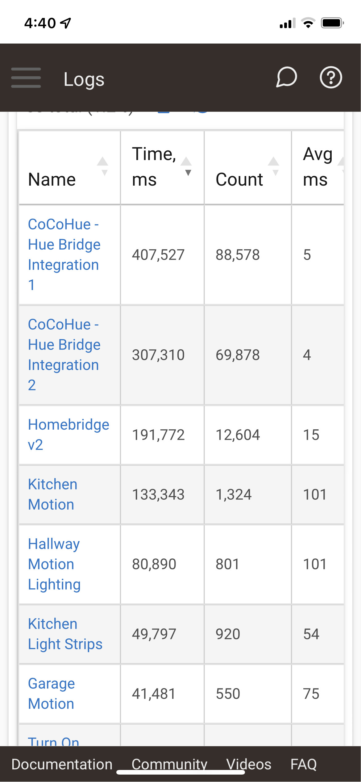

It looks like something is slowing down your lan. I have 2 Hue hubs as well, but my average ms are 4 and 5.
