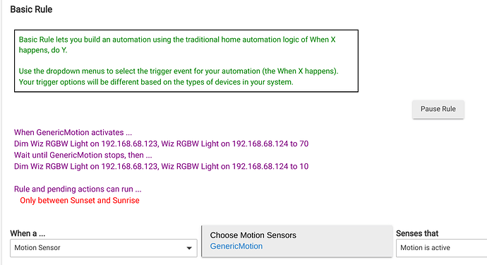

Post a screen shot of your rule include Required Expression and Triggers.
Hi. Thanks.
Is this enough of the screen?
Thanks.
The Only between Sunset and Sunrise looks okay to me. Is there any chance that you have a second rule controlling these lights?
