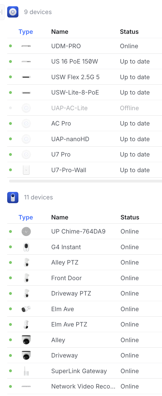

The Unifi Protect cameras are really good at detecting people. This has cut the false triggers to maybe one a week. It is an expensive option but I was already invested in them. When the Unifi integrations became available it was a game changer.

Unifi stuff is amazing… it’s like enterprise level management for your home network.
Installed a U7 router …switch …and an access point just a little while back. They’re amazing… UniFi cameras are the next step.
The most bang for the buck I’ve ever got as far as I’d say in router equipment

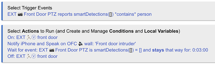

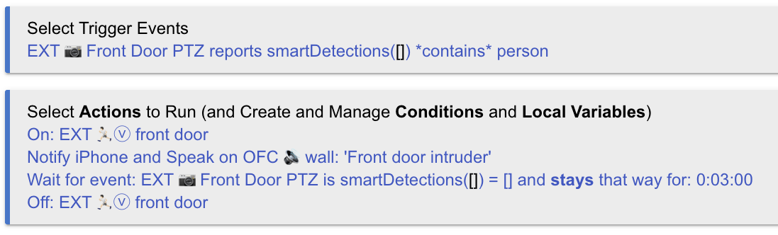

There is a built in Unifi integration. It was added a couple of releases ago. I have also used the Unifi Protect alarm manager to send alerts to my phone.
Here is a Rule Machine rule using the integration:
