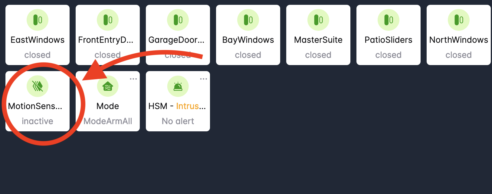

Hello, I have loaded the Konnected driver for my motion sensors ( konnected-motion-sensor.groovy. I have configured 1 motion sensor on Zone 1.
It only shows as inactive, and the Dashboard shows an icon with a line through it. Any advice on where to begin troubleshooting?

How does it appear on the device details page? For both the motion sensor and the virtual device created for the zone.
Hello - thanks for the reply. I think I found the issue. I was attempting to configure two motion sensors into the same zone. It seems that this will not work and that each sensor must be on its own zone. When I split the single zone out into two zones, all was fine.
