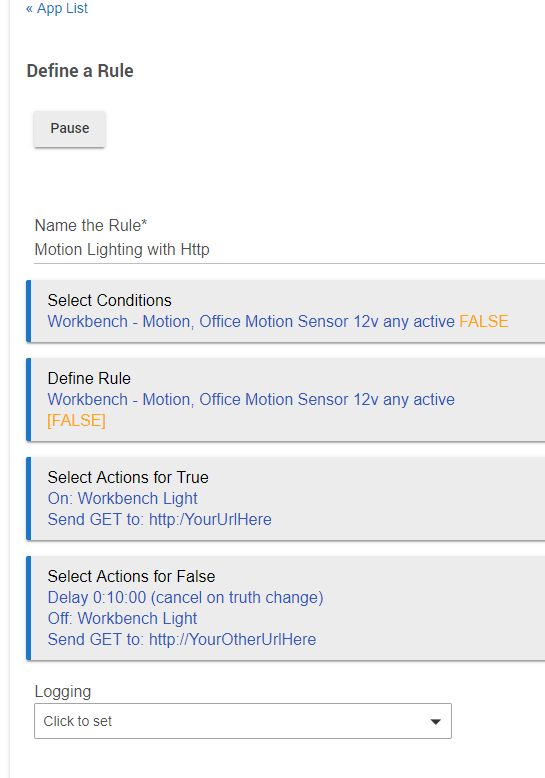

I am putting 2 motion sensors in my garage. I want motion to turn the lights on, and if no motion for 10 mins to turn the lights off. Basically, if there's motion again, I want this 10 minute timer to reset.
The second part of this is that the lights are controlled via Vera. I can turn them on/off via HTTP to port 3480 on the Vera. Is there a way to make a rule hit an HTTP link for the on command and another one for the off command?

This can be done with a simple rule in Rule Manager. See example below...I'm assuming the hhtp endpoint you are hitting requires a GET request. If not, Post is an available option as well in RM.

The rule you have seems to work great. Thanks!
