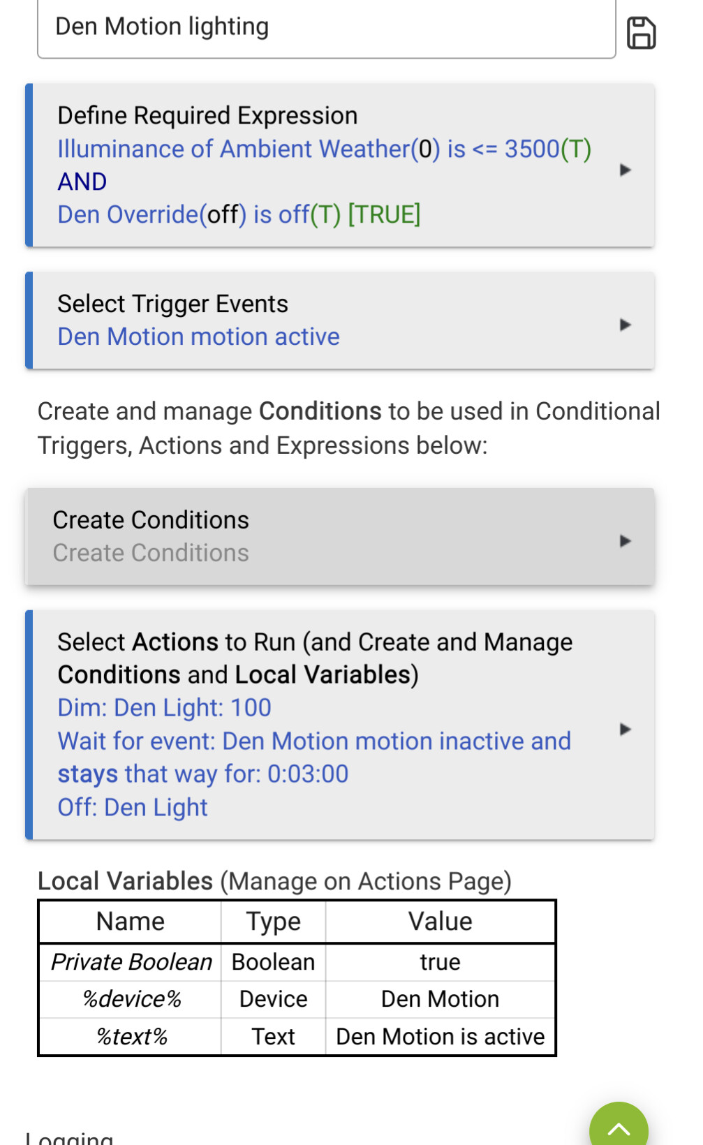

Trying to clean up some of my apps and I'm the process migrated one lighting rule to rule machine.
But something doesn't seem to be right.
A couple times now, I've had the light turn off on me while I'm still in the room and I'm plain view of the motion sensor.
I haven't turned any logging on yet. Hoping one of you will see something obvious I'm missing.
I did look at den light events, every time the motion sensor goes active I see it setting the dimmer level on the "den light" dimmer switch.
Not sure if my 3 minute wait is the wrong thing or what to use. Or maybe I need to set cancelable to yes on the wait?
It always worked as a simple rule. I just let RM bring it over.
The Delay should be changed out for the following
Wait for events: Den Motion motion inactive and stays that way for 0:03:00
This will restart the rule if motion goes active within the 3-minute "delay"
Gotcha.
Should I be sending the dim:100 every time to the switch, or should that be a conditional action, only if the switch is off?
I don't believe re-sending the dim command will harm anything so I would say adding a conditional action would be a personal preference. You could also consider adding a Req Exp for the light being off (or not at 100%). That way when it's dimmed to 100% the rule won't re-trigger.
The main thing annoying about re-sending it will be if anyone tries to manually adjust that dimmer. They'll find that it constantly returns to 100% as soon as they move again.

This scenario is actually where I really like the new conditional triggers. You could set up the rule similar to:
Triggers
Motion (only if light is off)
Inactive and stays for 3 minutes
Actions,
If Motion, dim light to 100
Else, light off
That's a good point I didn't even think of.
I just setup the conditional trigger so it only sends dim:100 if the switch is off.
