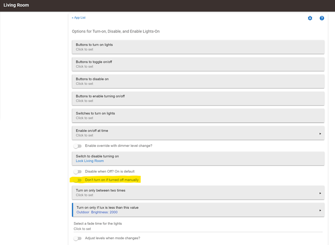

I've been playing with the motion lighting app more recently, and had used the Dont' turn on if manually turned off option on a couple of my rooms / lighting rules. Now, however, I don't want that behavior anymore, and have unchecked the option. The lights still refuse to turn on when motion occurs, even if I manually turn the lights on to try to reset the state.
I enabled logging for that motion lighting app, and see that it is still affecting it:
Is this a bug? Is there any way to correct the issue without simply removing that motion lighting app for living room and recreating it?

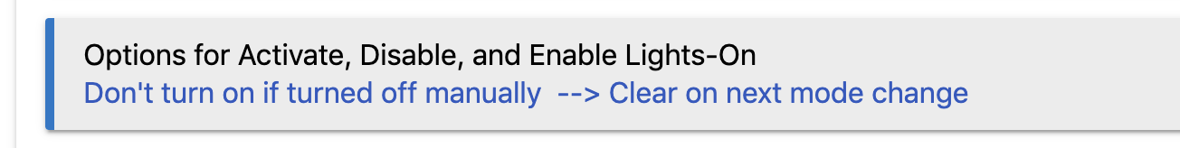

This feature, "Clear on next mode change", will be in the next release. We will see how this goes, and whether or not there is a real need for further means of clearing the "Don't turn on if turned off manually" condition.
