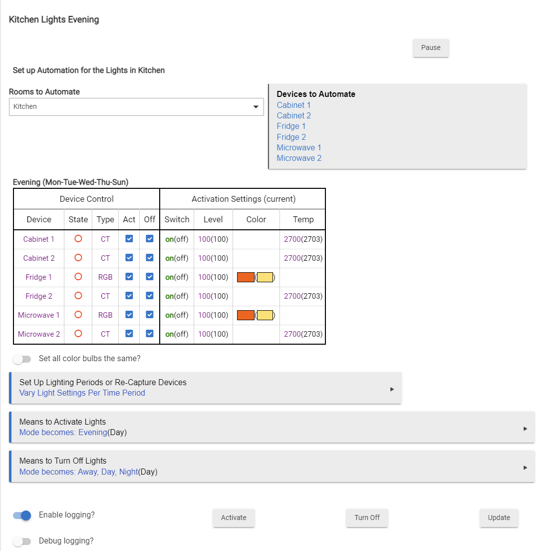

Please show the page of Room Lights that does this.
Sure!

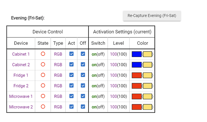

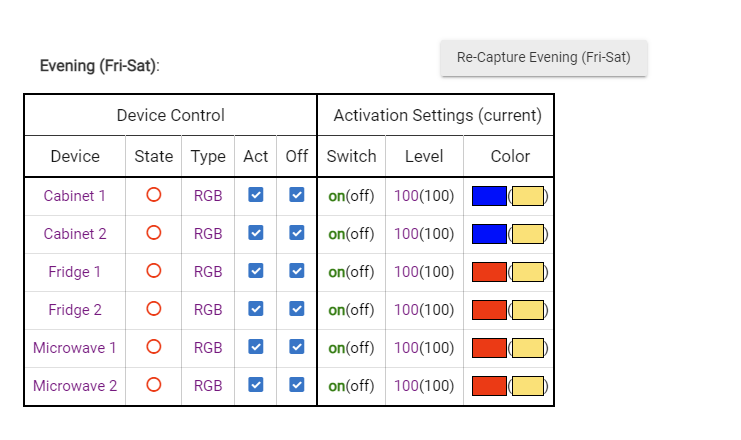

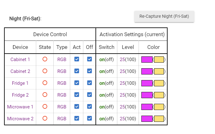

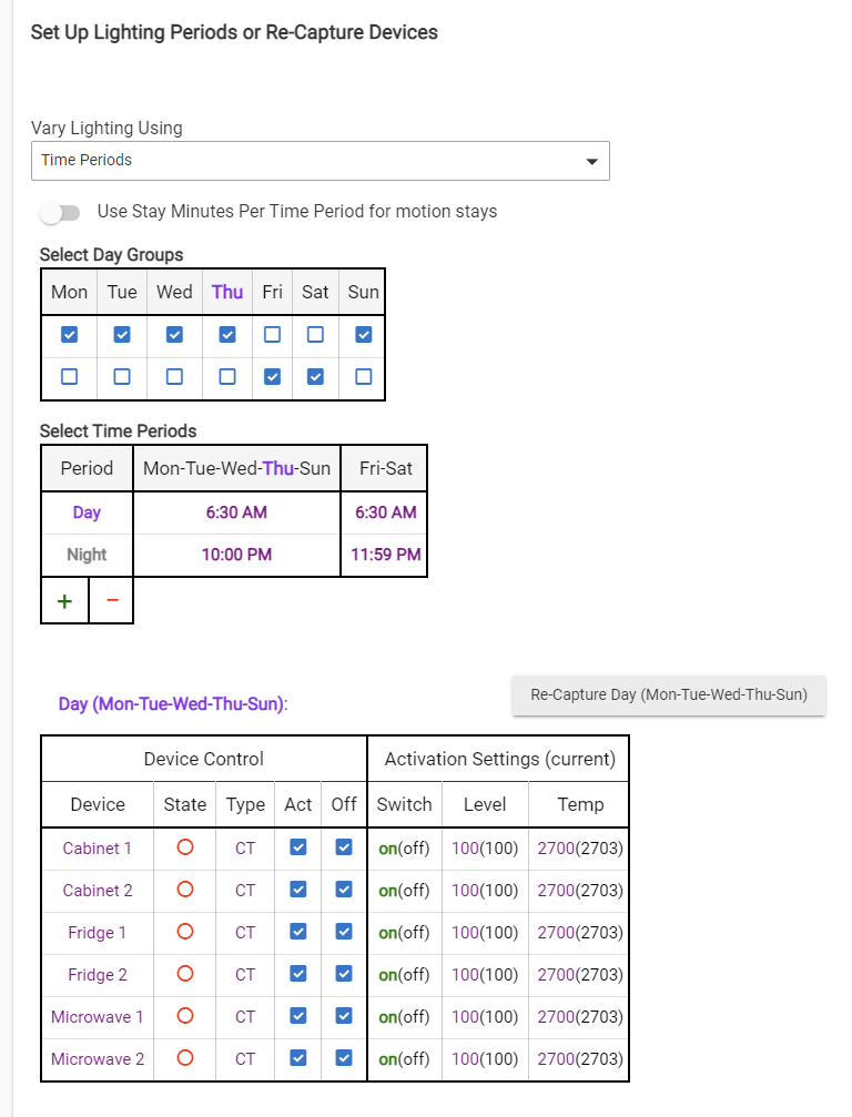

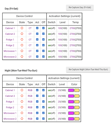

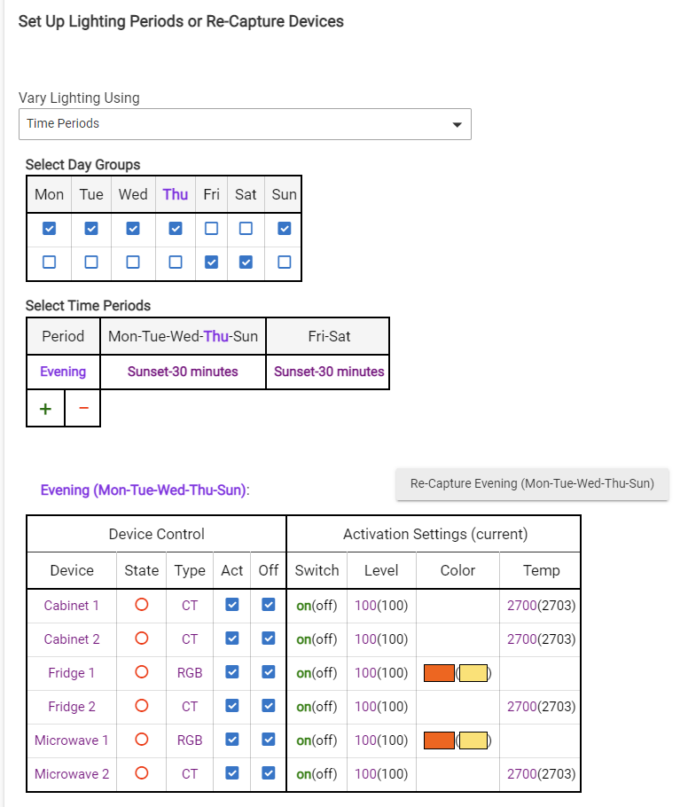

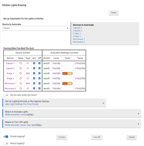

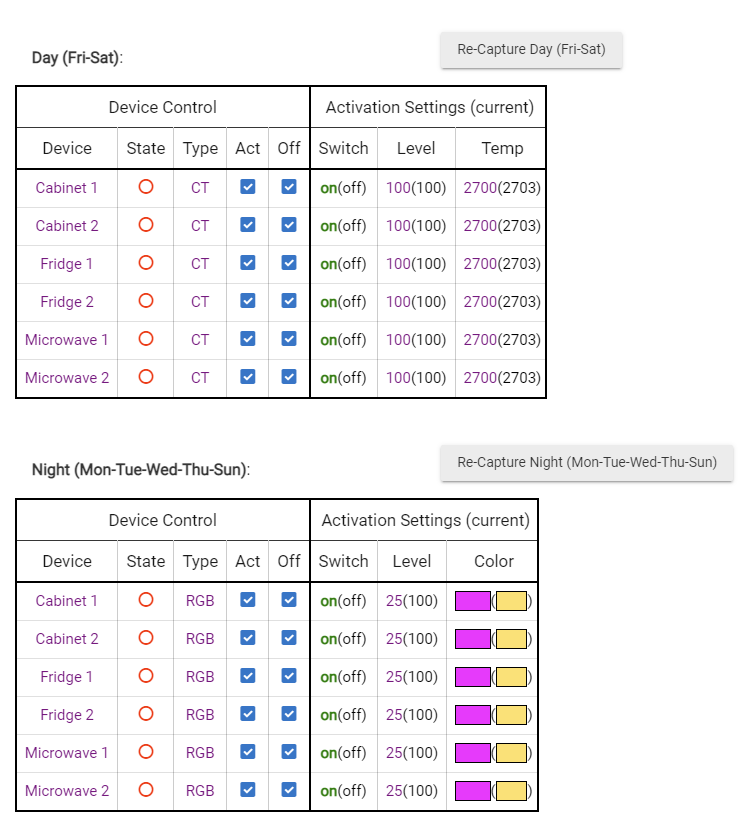

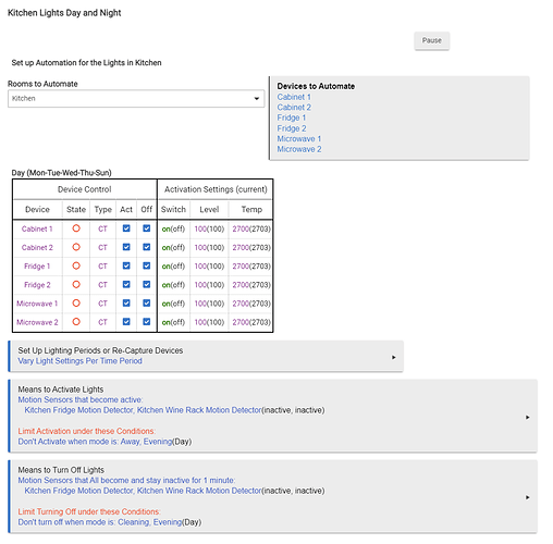

This is happening in multiple rooms, however for this example I'll provide the kitchen. I couldn't find an easy way to keep the kitchen lights on solid for my "Evening" mode, so I've created two entries in Room lighting. One that covers motion lighting for Day / Night and another that covers the solid non-motion lighting for Evening.
If the rules look odd, it's because we run coloured lighting on weekends throughout the entire house. We also have night lighting setup for "follow-me" night lighting.
This is how I handle the "Evening" mode:
Just to add, a good example of this would be if a cat is wandering around in a room with motion detectors and that specific mode lacks any logic to enable the lights. The mode changes, and because the motion detectors are still active the room will wait for the 60 second cooldown that started before the mode change before the lighting in the room will activate.
It leads to us asking "Why aren't these lights working in here?" - and the answer is to stay out of the room for 60 seconds for the cooldown to lapse. Once we do that, everything works properly.
