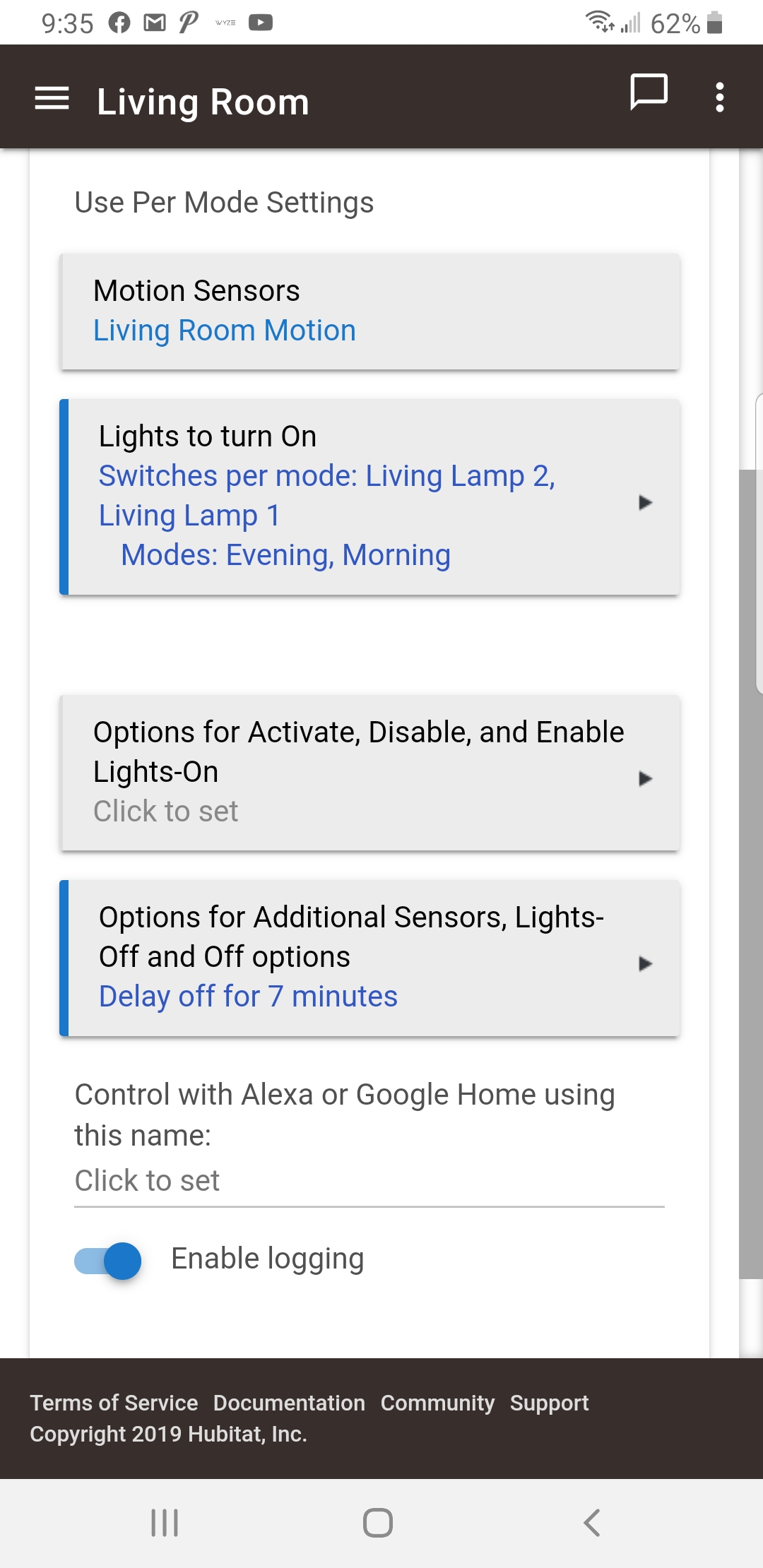

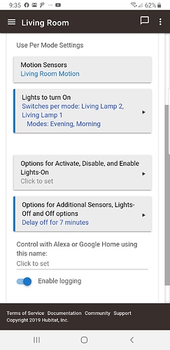

I have a Motion Lighting app setup to the following
If mode is morning > motion is active > turn on Living room lamp > delay 7 mins > turn off
Pretty simple I would say.
Morning mode = 6am - 9am
Day mode 9am - 6pm
If my lamp is on at 8:59am and motion become active timer is reset to 7 mins after motion is inactive. Now the lights will not shut off till 9:06am. That's ok I guess but if motion is detected at 9:04am the log says not turn on...already on which is true but resets time for another 7 mins.
Why is Motion Lighting still working when at 9am mode was changed to day?

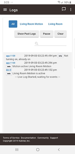

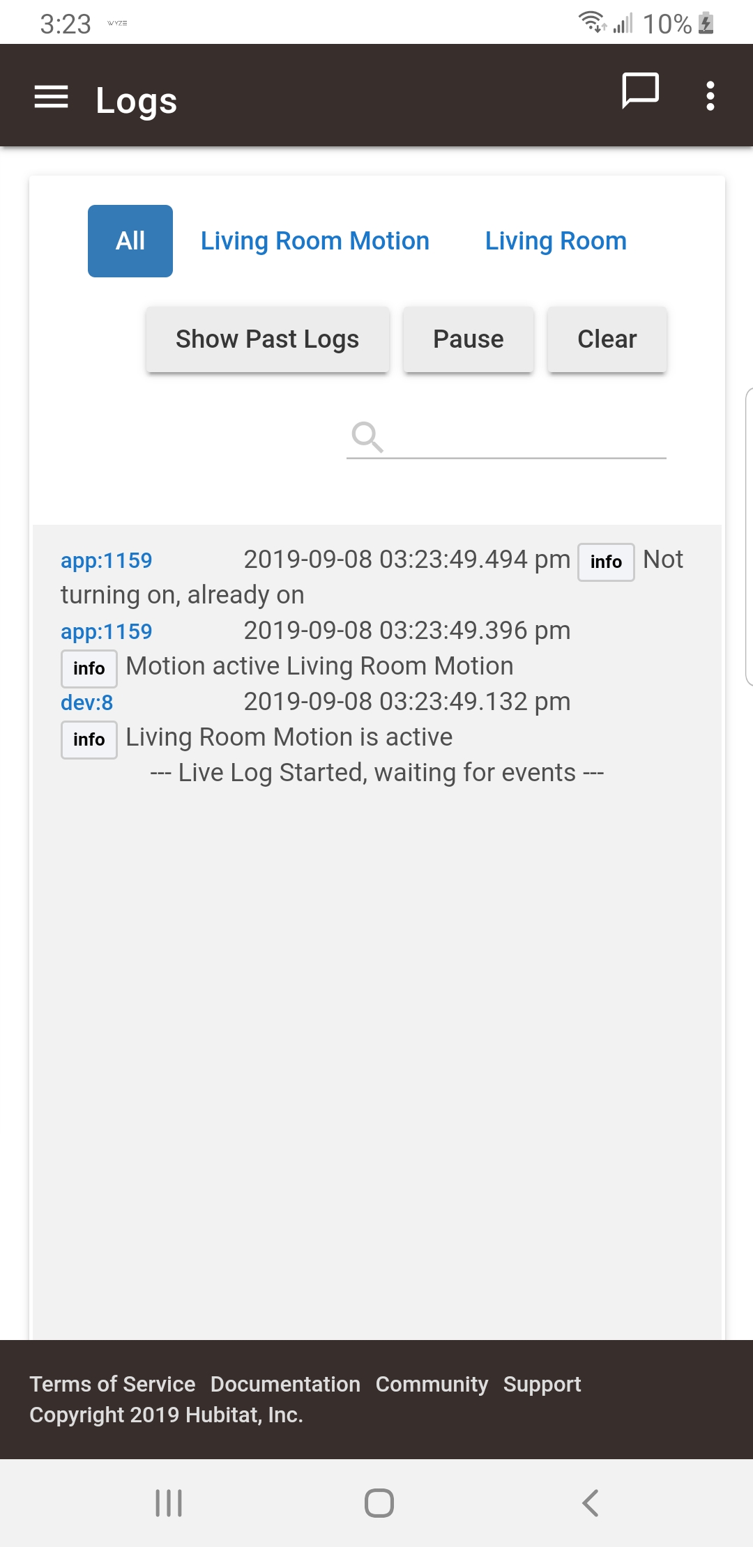

Here's something else I'm seeing. Motion lighting set to morning & Evening mode. It's currently showing in Day mode so lights should not come on. When motion is active lights do not come on which it shouldn't but log says not turning on... already on
Lights are off and looking at device it's also showing off.
That's most likely an artifact from before. There is a bug fix in the next release that addresses that issue.
