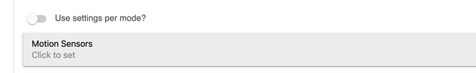

Is it possible to set dimmer level per mode from the Motion Lighting App?
Use case: Light in master toilet should not come on 100% while mode is sleep - but should be 100% when mode is day.

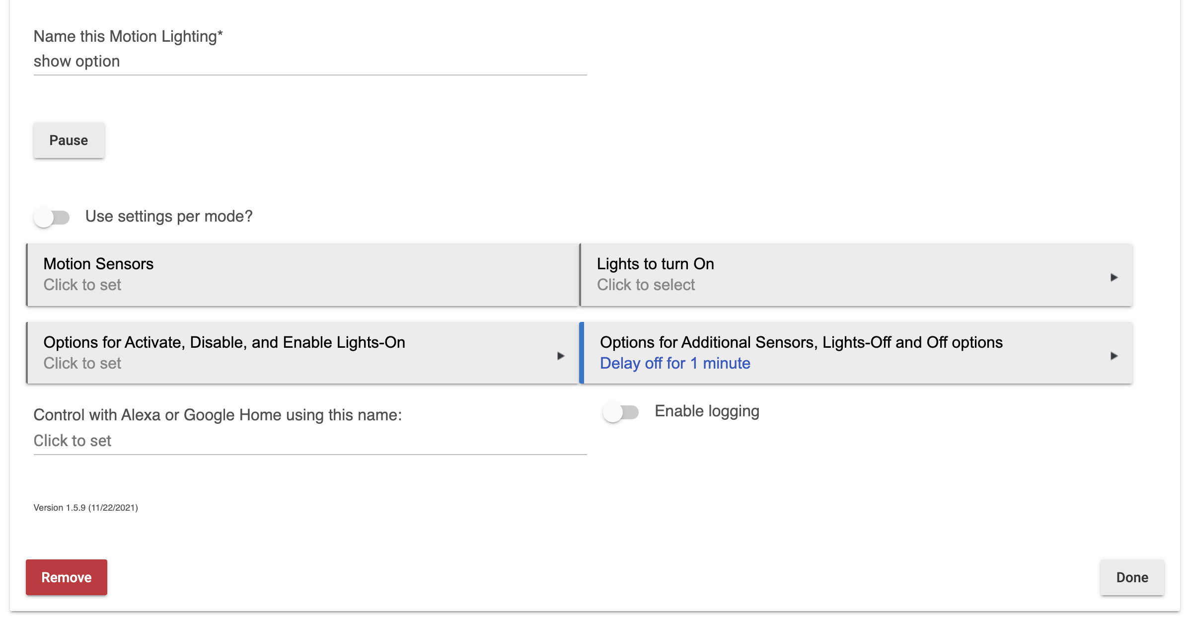

Has this selection option changed? I cannot seem to locate it.
I see it. However, a bit of a mis-communication on my part.
