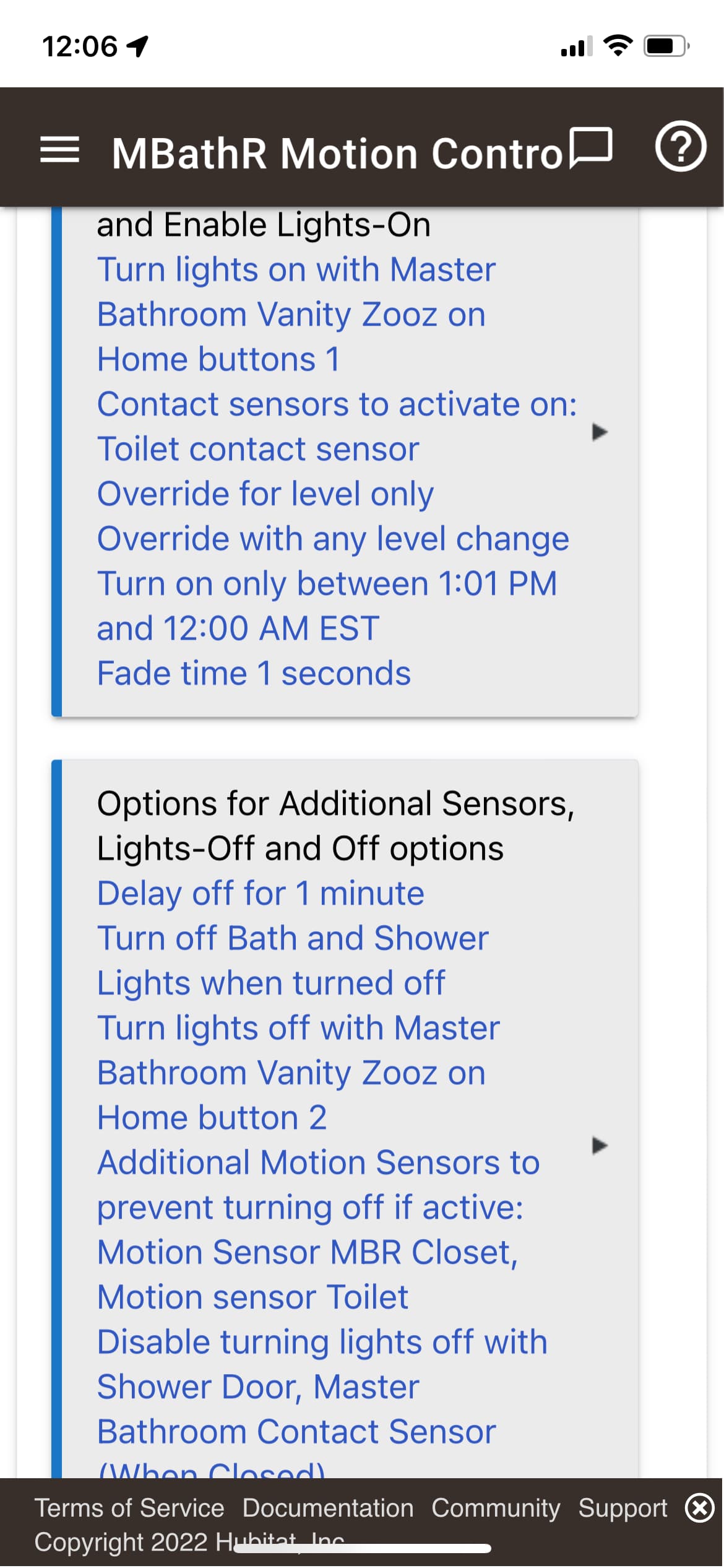

I don’t see in your post how you set it to not turn on during the day, but I set mine for between 2 times, which you can see in my screenshot. I also select any buttons or switches that I use to turn on/off the lights and don’t duplicate this function in apps like Button Controller or RM just to make sure that ML knows the lights are on or off.

I don’t think that’s necessary, so long as the switch is reporting it’s state properly back to the hub. I’m using Zooz Zen77 dimmers set to “smartbulb” mode to control Hue lights in my setup, so I have included which buttons I want to have control on/off of the lights (which ML then monitors the events of and turns them on/off without needing a separate rule).
I think it might be the mode selection that’s making it not work for you. Try selecting all of your modes and fill in the brightness settings, etc. then select the “turn on only between 2 times” option to keep it from turning on when you don’t want it to. Sunrise/set are also options in the setting.

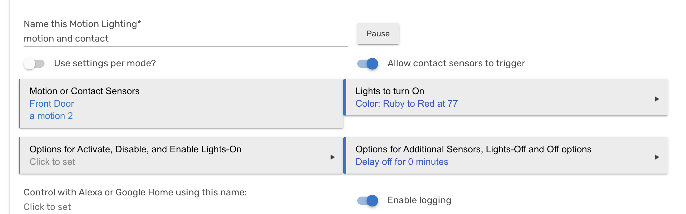

Support for actual contact sensors was added two or more years ago. I posted a screenshot of my ML instance that will shut the lights off while restricted to not turn them on that also includes a contact sensor turning it on. I did trigger the motion sensor in my test as I didn’t think it would turn off otherwise.

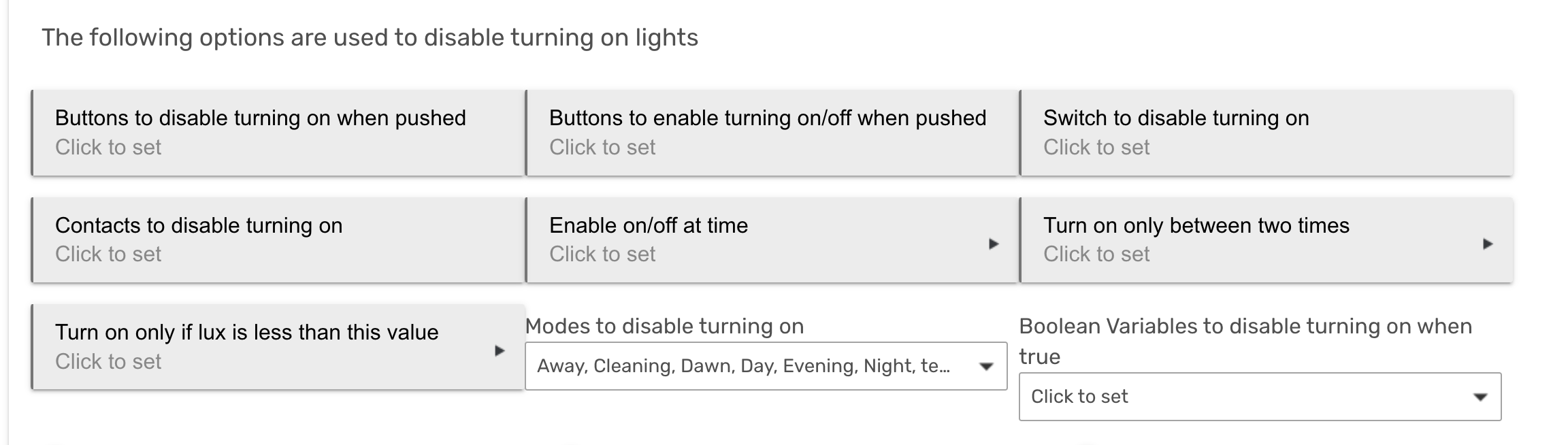

Please show what you have to do (show the rules used) and explain what you mean by ML not doing "vacancy on its own".
If you mean that you want ML to turn lights off when motion stops (some time after that happens), but not to turn them on from motion, it will do that. I guess that assumes that the lights are turned on by some other means. This is accomplished by using an option to disable turning the lights on, such as selecting every mode for 'Modes to Disable Turning On', or using a Hub Variable, etc.
I know there is "Modes to disable turning off"... but is there a "Modes to disable turning on" too? If yes, then that might be the answer to my original question.
Yes, there is such an option. See screenshot above (yours may not be laid out the same way, but the option is there). ML doesn't care who turns on the lights, itself or someone/something else. The on and off logic of the app are separated, and it monitors the state of the lights.
This is my screen(C7 - 2.3.0.124).... perhaps it is not in the latest production version?
