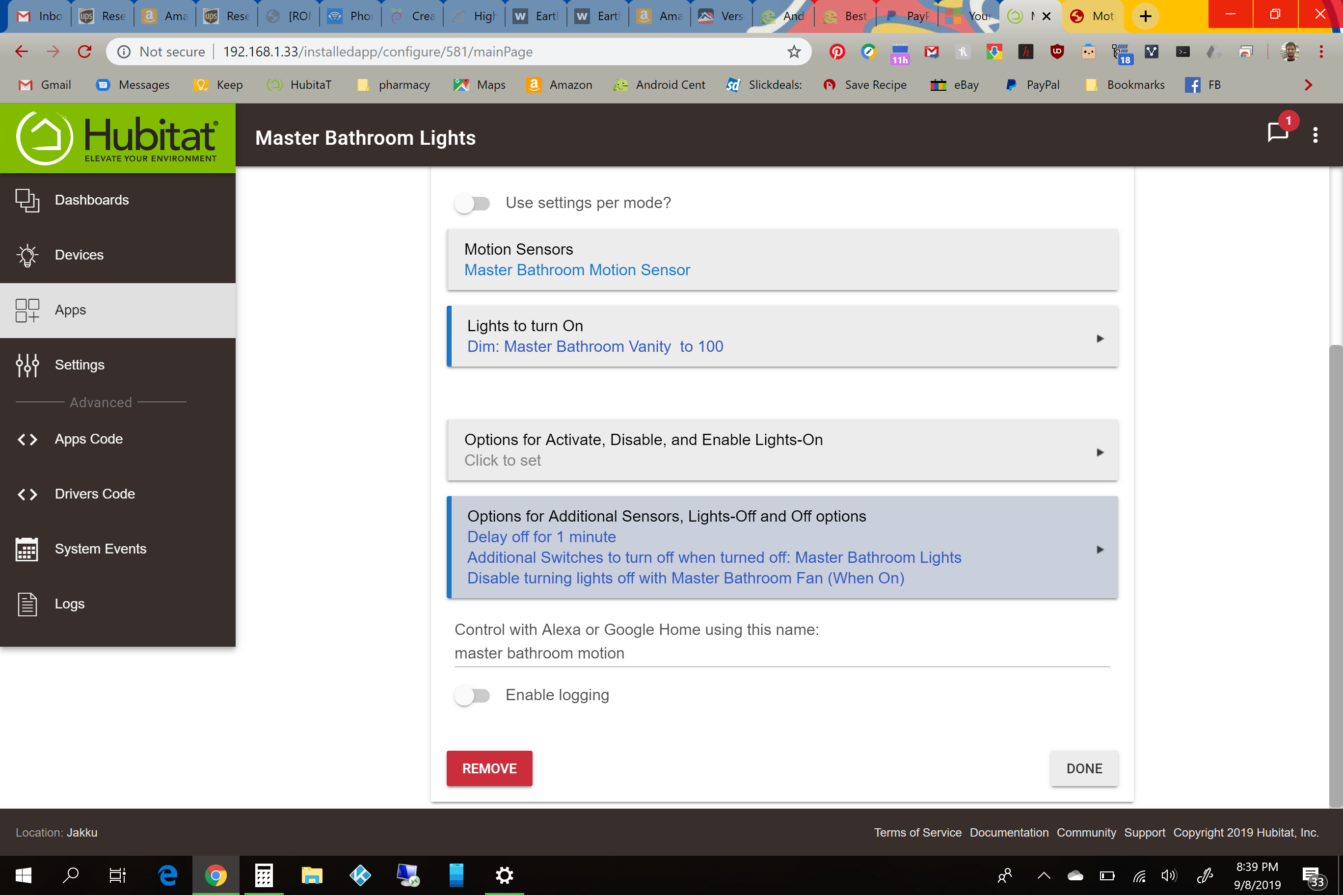

I want to set the motion lighting in my bathroom to disable turning off lights when the shower fan switch is turned on. The motion lights keep turning off when I am in the shower because the sensor cant see me. Here is a pic of my set up but this doesn't seem to work. Please help.
Have you tried putting in under the enable the bathroom fan being off?
Not sure I understand. I want it to disable the lights turning off when the fan is on not off.
Enable logging and post the logs. Sometimes I just have to delete and recreate a motion lighting app to get things working right. It can be a bit buggy and sometimes a setting will get stuck enabled even when you disable it.
Going to do that now........ I may have to switch to rule machine instead because I would also like it to do full bright during day but only a dim setting at night. I don't see anyway to make motion lights do this.
When you say "it doesn't work" what exactly is happening? You describe what you want to happen but not what is actually happening. Maybe I'm not understanding the problem statement. Are you saying that the lights still turn off when there is no motion even when the fan is on?
Also, do you ever turn these lights on by the switch? if so, you have to define that in the rule as well.
What type of motion sensor is this? a 1 minute timeout is not very long. My bathroom motion rule has a timeout of 3 minutes.

exactly the lights still turn off even though the fan is on. I do have a switch for the lights but never use it anymore since I have the motion turn the lights on. This is a smart things motion sensor and works well. I just can't seem to set up a way to make the motion rule pause turning off the lights. I want the fan to pause the motion off and then reactivate when the fan is turned off.

the log doesn't show much.
That's not the right logs. Click on "Logs" in the left hand menu... the very bottom option in your screenshot.

Here is the log..... The fan being turned on doesn't even show in the log
Does the fan change state on the device page?
