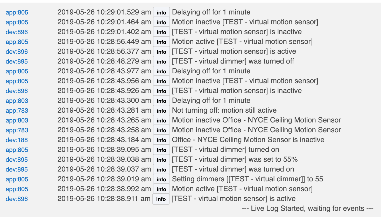

  2. Motion lighting does not respond to an Off, even when present. I first fixed the device handler to send an off, and second, tried this with entirely virtual devices. You can see from the logging below (ignore the Office NYCE alerts which snuck in) that Motion Lighting doesn't log anything after an Off from the virtual dimmer:

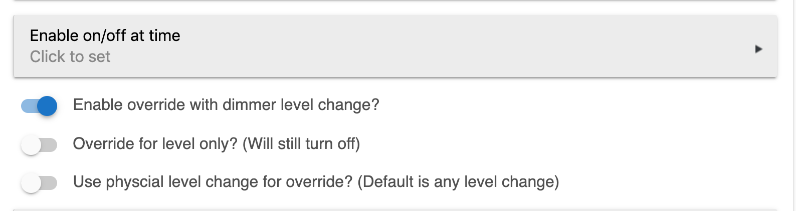

Try enabling override.
Tried, the light still didn't come on after another round of motion being active.
Setting I ticked:
Scratch that, I think it's working..
I believe I had the same problem. Finally figured out what to do to get past it.
