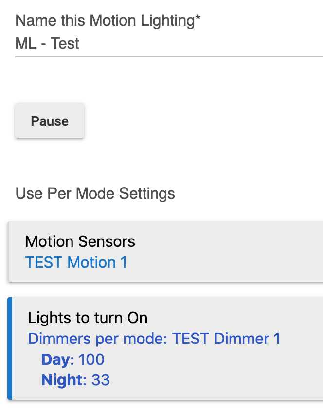

Most people here will make an RM rule for free if you say what you want the rule to do. :slight_smile: Motion Lighting can turn lights off with inactivity, but I don't believe there's way to get it to go to a specific level instead of turning off. But I'm not clear if that's what you're looking to do. Do you want it to always turn off but just turn on to 30% with motion after 11 PM and before 5 AM and to 100% any other time? If so, you shouldn't need RM for that--ML can handle it like this, with the "Use settings per mode" option (not pictured here, as it gets set and then disappears to reveal a modified UI) if you have a specific mode active at that those times:
If you aren't already using modes, this would be a good place to start. If you are and don't want to modify them for this use, you can just use two Motion Lighting or even Simple Automation Rules automations to work together and get what you want. I'd recommend the latter since it's a bit simpler to set up, but the "Turn on only between two times" option in Motion Lighting could do something similar. In SAR, you'd just use a restriction for time on both. Something like:

I have several lights setup with the Motion Lighting app using the Mode Lighting option such as:
Then in my other rules I just turn on or off that light and it comes on at the correct brightness.
