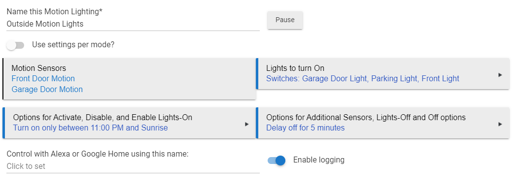

The Motion settings:

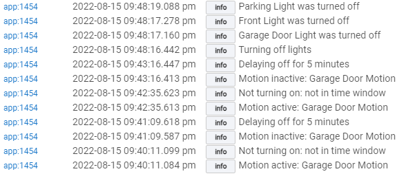

The log showing the ON action being ignored outside of the time restriction, but the OFF action still taking place:
Screenshot 2022-08-16 022949
This looks like a bug to me. The restriction should disable the rule outside those times. The fact that it's constantly checking the time to see if it should do something seems inefficient, and is also causing this issue.

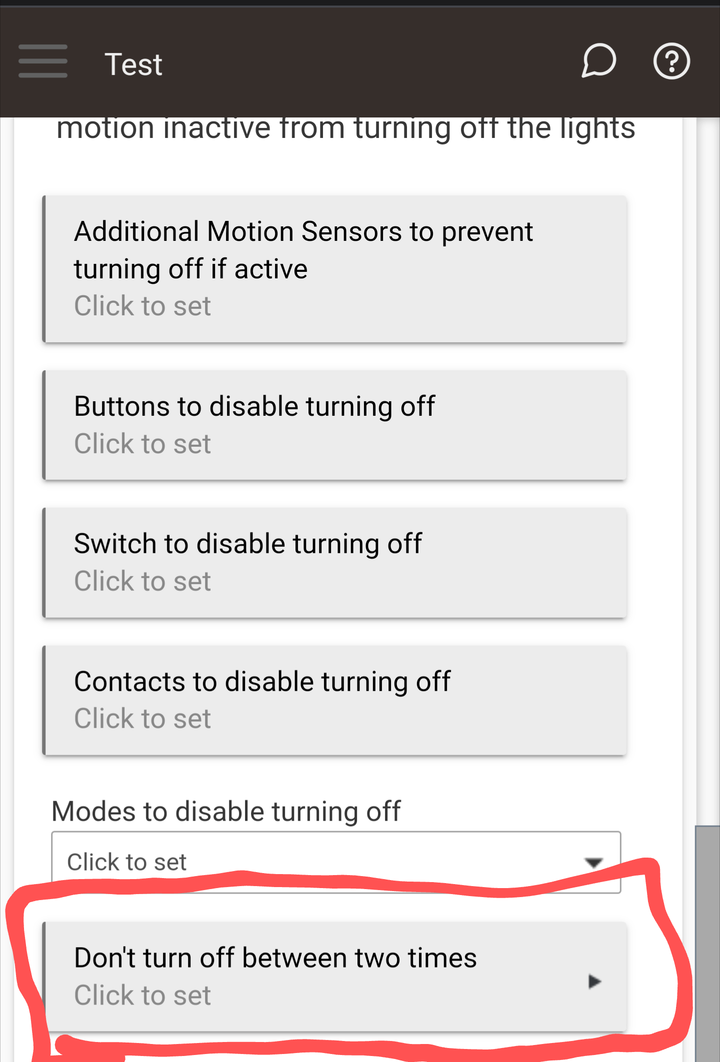

You have to also time restrict the "turn off" side.

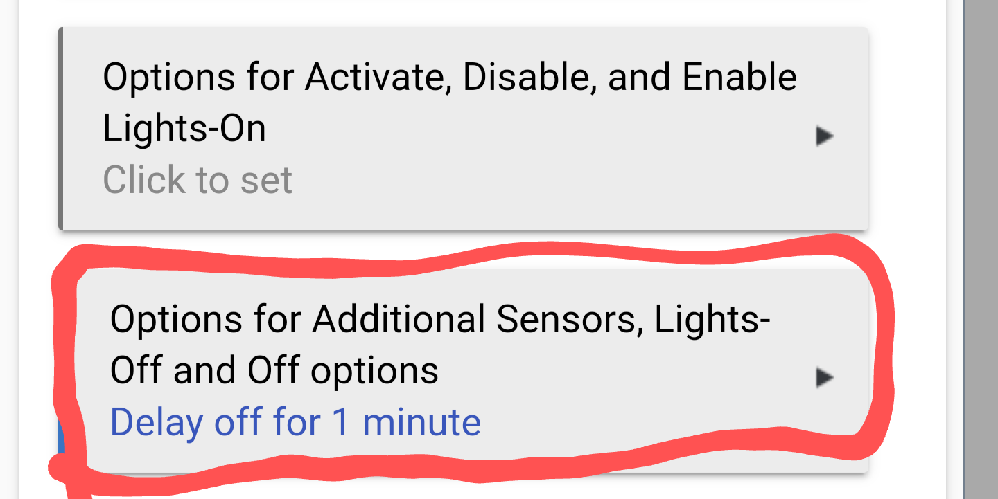

Interesting, ok! So it looks like my assumption of the ON "bug" was correct, except it was a feature.
I missed the corresponding OFF restriction, in the same place where the delay is set. I've updated my rule, will let you know how it goes.
