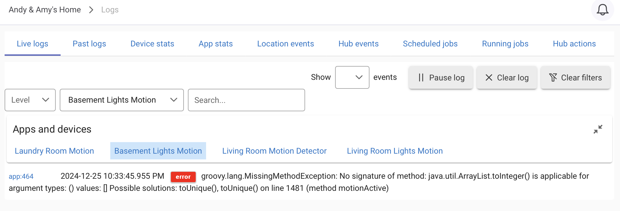

I've had trouble with Motion and Lights for a long time hoping it would get fixed. I finally moved on to the user app [Lights on Motion Plus] and that is working well. But I think the built in app needs to be fixed.

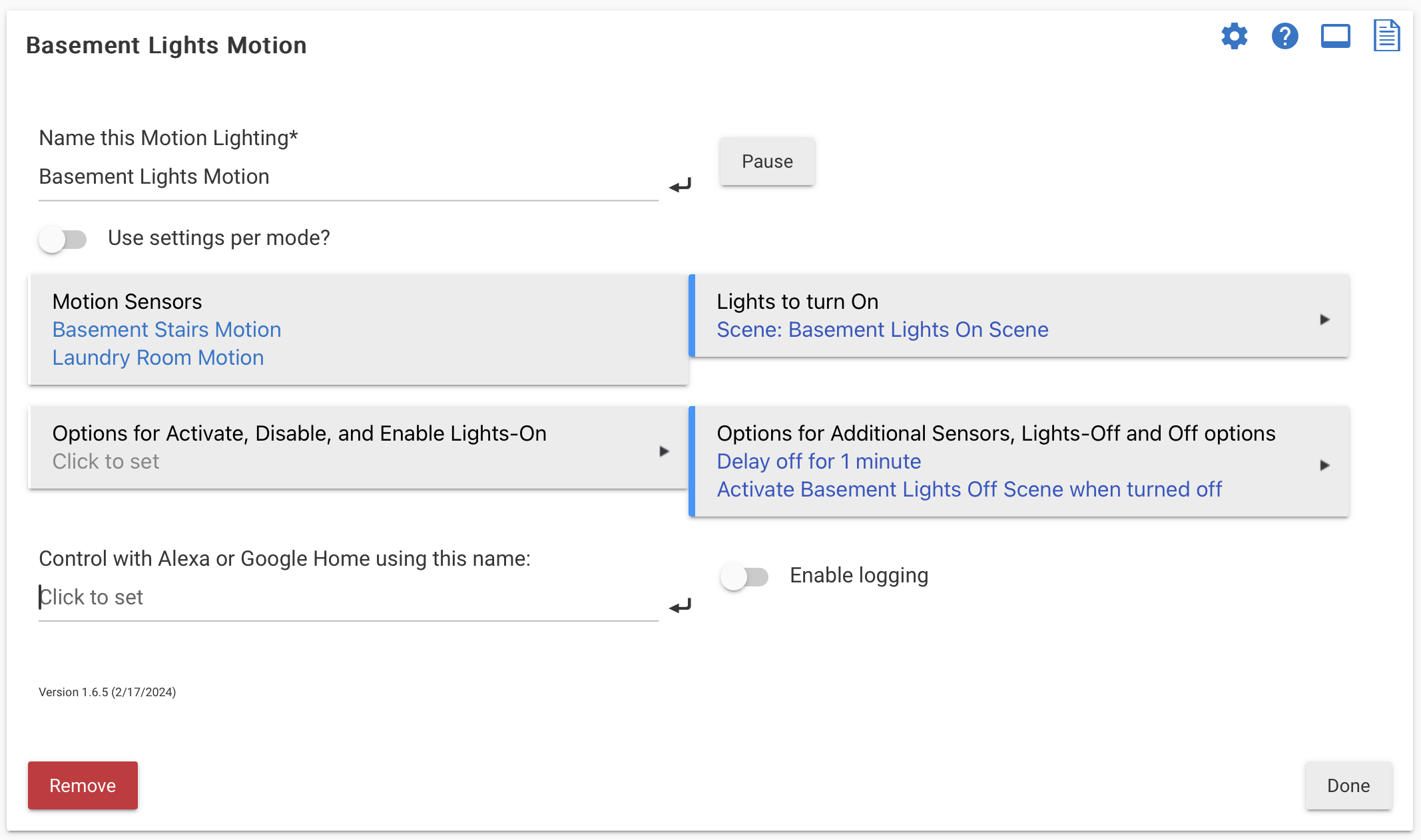

Here is my config, and then the error I get every time I trigger one of the motion sensors.
I have an idea what's going on, though it's not my app, and pretty much all development on it has stopped in favor of Room Lighting, which you might want to look at instead. You might be able to work around this by using the scene activator device as a regular switch in your "Lights to turn on" page instead of as an option under "Select scenes" on that same page.
