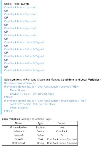

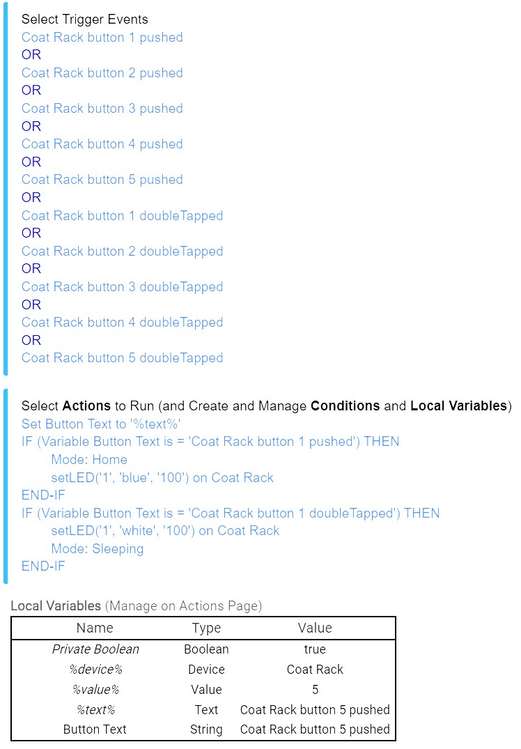

Yes - what your showing to do branching/conditionals on the "Button Controlled Pushed" or "Button Controlled doubleTapped" conditionals in your actions will NOT work. - For all the reasons the @kkossev has stated several times about states - His key statement was
"The buttons are stateless. You can use only the event generated in the RM5 rules as a trigger. Inside the rule you can not check the ‘pushed’ or ‘double tapped’ states, as there are not states for buttons. Only events."
it's not a question of likes/dislikes/preferences or "bad form/complex/simple" - What your trying to do with conditions in your actions on stateless buttons attributes WILL NOT WORK. - So while you may not like breaking things up by each "trigger" (which is what the button controller app, is basically walking you thru) - Where you have blocks of logic per each individual button trigger.
Folks seem to be talking past one another, but this isn't a question of style, it's "this is the way that buttons work", and they are stateless, and you can't do conditional logic off these attributes, no matter how much you keep trying (well, you can write the actions, they just will not work as you have discovered).
Perhaps try the alternative (breaking things up per button which then removes the need for conditional branches in the actions) and confirm that works (or not), then we can get back to stylist pro/cons. And we can talk about RM functions and other alternatives to "shorten/consolidate/reuse" code.

I don’t have one of these switches, so I can’t test this. However, does this switch have the attribute “lastButton“? If so, set a variable to that device attribute value and test string values that could be sent by button presses.
Also, in your original post rule, why are you testing button presses against decimal values? Is that expected output from that device? Also, I didn’t understand why you were testing the same button for two different values, 1.0 and 2.0. I also suggest that you try instrumenting your original rule by outputting to the log the actual values being presented by the device to verify if your equalities make sense.
Hubitat defaulted to the decimal stuff…and even I was wondering if it was going to work. But it does. It’s not the same button. It’s button 1 and 2 out of 4…I’m catching any single press from ANY one of the 4 buttons and running events based on each.

I have this working and understand most would use the button app. It’s just my personal preference to like to see every action for a device in a single rule. I’d need 12 button rules with the app to get this done. 4 Single tap - 4 Double tap - 4 long press. Right now I’m using one rule for single tap…one for double tap…and one for the long press.
Because of my preferences, I’m probably going to change over to match text in responses so I can do it all in single rule. I think I have this now…and really appreciate your time. THANKS!
