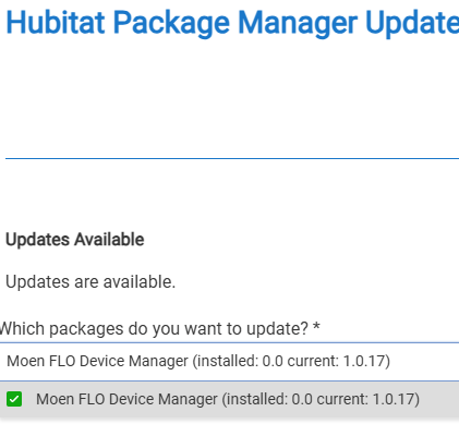

My Hubitat Package Manager shows there is an update for Moen but I run the update and nothing changes. Anyone seen this?

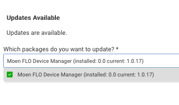

Unable to duplicate:

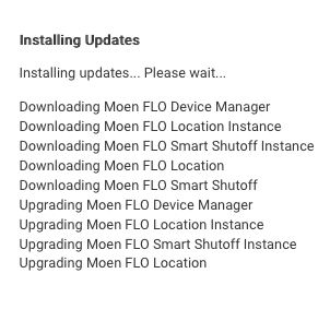

app:1222 2025-12-18 09:11:15.950 PM debug Updates complete
app:1222 2025-12-18 09:11:09.821 PM info  Upgrading Moen FLO Smart Shutoff
app:1222 2025-12-18 09:11:03.291 PM info  Upgrading Moen FLO Location
app:1222 2025-12-18 09:11:01.454 PM info  Upgrading Moen FLO Smart Shutoff Instance
app:1222 2025-12-18 09:10:59.710 PM info  Upgrading Moen FLO Location Instance
app:1222 2025-12-18 09:10:55.927 PM info  Upgrading Moen FLO Device Manager
app:1222 2025-12-18 09:10:55.809 PM info  Downloading Moen FLO Smart Shutoff
app:1222 2025-12-18 09:10:55.701 PM info  Downloading Moen FLO Location
app:1222 2025-12-18 09:10:55.604 PM info  Downloading Moen FLO Smart Shutoff Instance
app:1222 2025-12-18 09:10:55.503 PM info  Downloading Moen FLO Location Instance
app:1222 2025-12-18 09:10:55.405 PM info  Downloading Moen FLO Device Manager
app:1222 2025-12-18 09:10:54.988 PM debug Performing update

I don't have Moen, so I installed the Package, without any optionals. Then I unmatched it, then ran a Match and it found the package. I did not mark it as up-to-date, thus arriving at a match to your screenshot: "installed: 0.0 current: 1.0.17"
And finally, I did an update... which completed successfully as shown in the logs.
