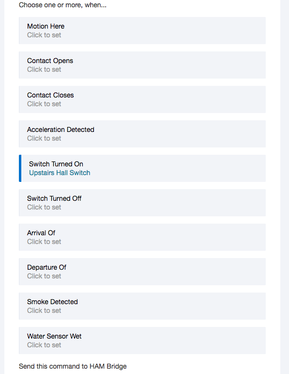

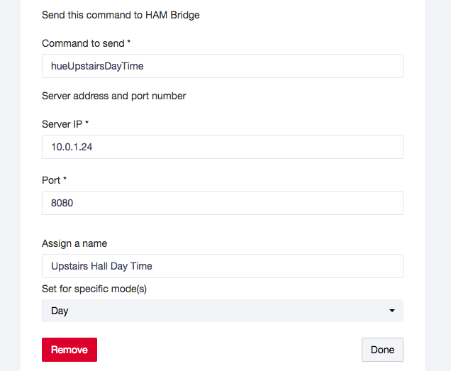

Please report this to support@hubitat.com. We will look into it. I don’t see anything about your app that would explain it. Could you post a screen shot of the app while it is open for configuration, with your mode restriction setting, or send it to support. That would be helpful
Here's how it looks when being configured.
We’ve determined there is a bug for sure. Will be addressed.

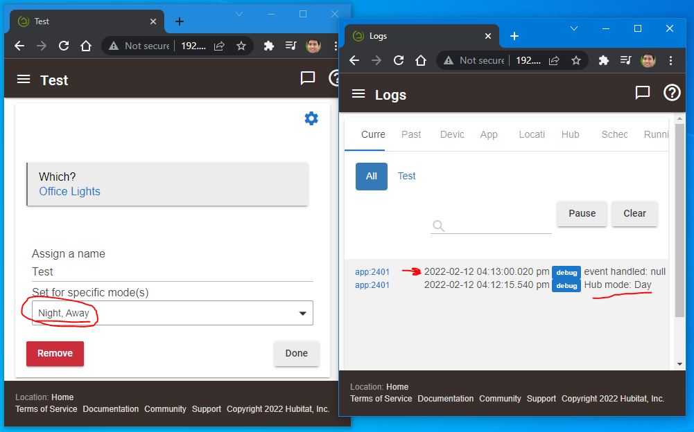

I am resurrecting this thread because it appears that the bug were fixed for subscribe but not for schedule nor runOnce. The SmartThings docs do not necessarily specify (mirror link, since the original Samsung docs are gone now), so is this expected?
This can be reproduced by creating and installing an app with the following code (please change the time on line 29 to an appropriate time) (please also see the attached screenshot):

    log.debug "Hub mode: ${location.mode}"
    // does not respect selected modes
    def scheduleTime = toDate("16:13")
    schedule(scheduleTime, eventHandler)
    //runOnce(scheduleTime, eventHandler)
    // respects the selected modes
    //subscribe(mySwitch, "switch.on", eventHandler)

I will send an email to support as requested earlier:
Without arguing the merits of doing it either way, there are implicit dependencies on this behavior 4 years later. Making this change now will cause breaks in existing apps.
That's fair. Thank you for the response.
