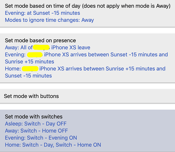

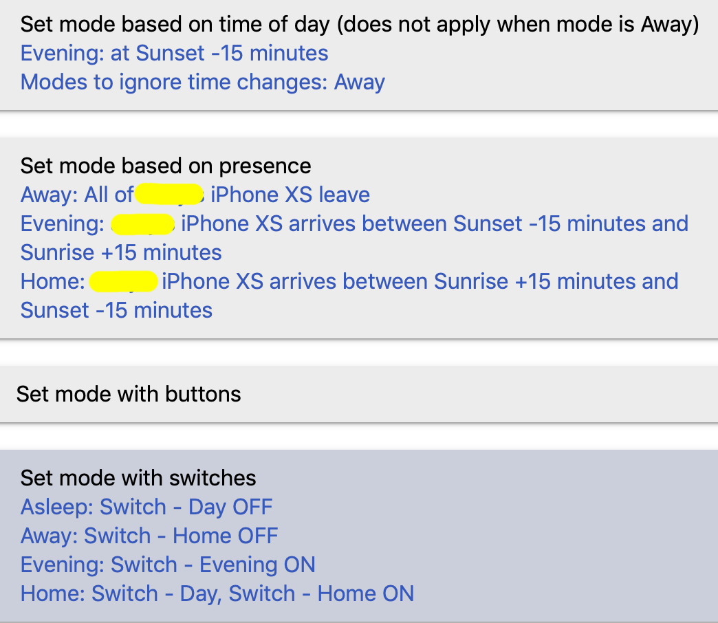

in mode manager, this seems to do what you need, at least it does for me.

This is what I do. I have four modes: Home, Evening, Asleep, and Away. Home, Evening, and Asleep apply when I'm actually at home. And Away is only when I'm away. In Mode Manager, I set modes based on time of day, presence, and virtual switches. The switches are controlled by Rules, and sometimes by Alexa.
