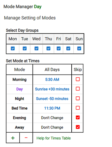

I have 4 mode setup
Morning set at 5:30am
Day set at sunrise
Evening set at sunset
Bedtime set at 11:30pm
At 11:30pm ( Bedtime Mode) it also sets Alarm
At 5;30am (Morning Mode) disables Amarm

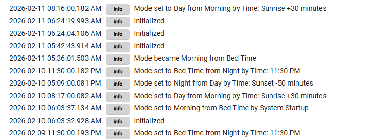

The last 2 mornings the hub failed to switch to morning mode at 5:30am causing Alarm not to be disarmed.
All through the day modes work fine.
After a reboot yesterday morning when hub came back online it switched to morning. This reboot was done after 6am

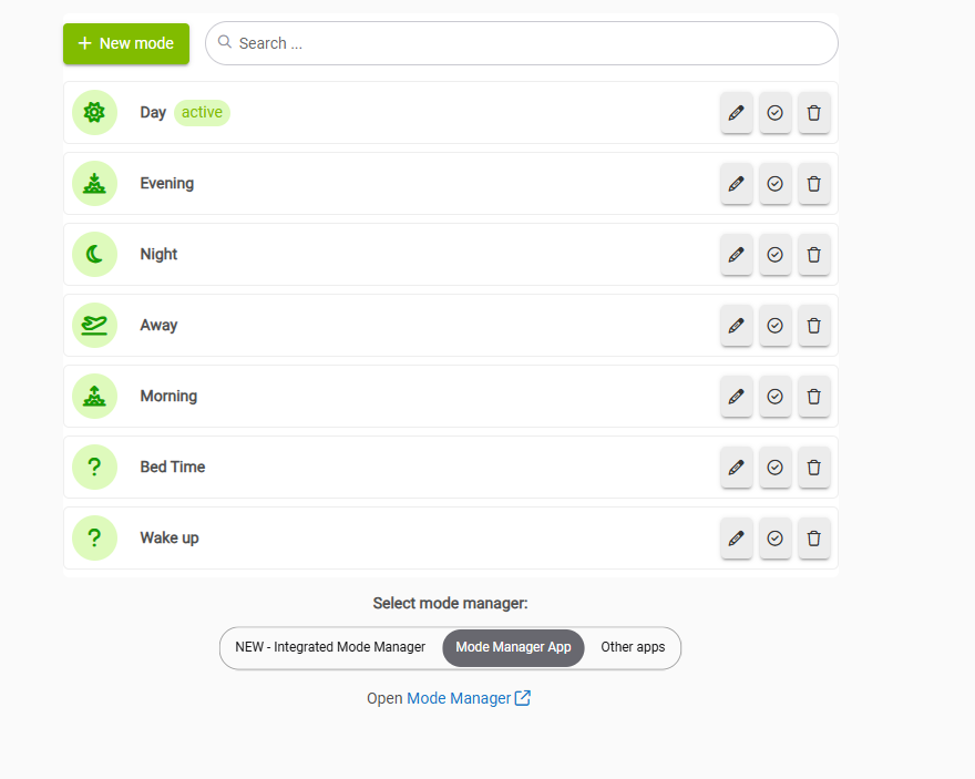

It'll probably help to know which revision of the OS your hub is running, and whether its modes are being managed by IMM or legacy Modes. Also, what's showing in the Logs for those specific timeframes?
Version 2.4.3.177
At the 5:30am mark in the logs you can see I manually put it in Morning Mode. Then at 8:16 it auto switched to Day

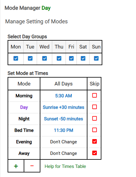

The semicolon in a forum post (or any other typo, like “amarm”) probably isn’t relevant to how the time is input in the actual hub UI (it’s not a free-text input). See screenshot #2 in post #3 above.
I'm gonna suggest the OP revisit the "Mode Manager" app, and click DONE, just to make sure all of its settings are correctly saved.
Brief testing with classic Mode Manager on my C-7 reveals that Mode won't switch at the chosen time if I only clicked "Done with time" but skipped clicking DONE.
