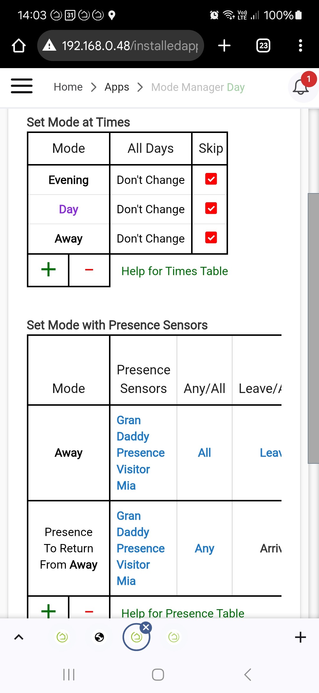

Ive the below set up, and when i come home it keeps changing the mode to night.
I would expect it to keep track of the modes and when i come home switch to day or evening.

I want the mode to be selected basesd on time from return from away.
Its not, thats whats baffling.

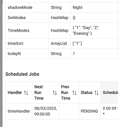

According to the instructions having the time set in the background, as per details page, would make the hub select the appropriate mode on returning from away, but it been selecing night mode. Might be a running over midnight glitch??
No, i actualy delete the app and started from scratch making sure not to add night before posting, thinking the same that something was hanging on
Just one for tomorrow, strangely missing this evening.
