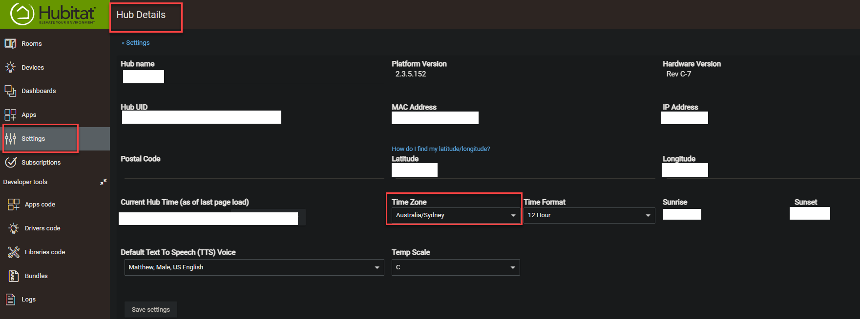

I would suggest checking your Settings to make sure the local timezone has been set correctly:

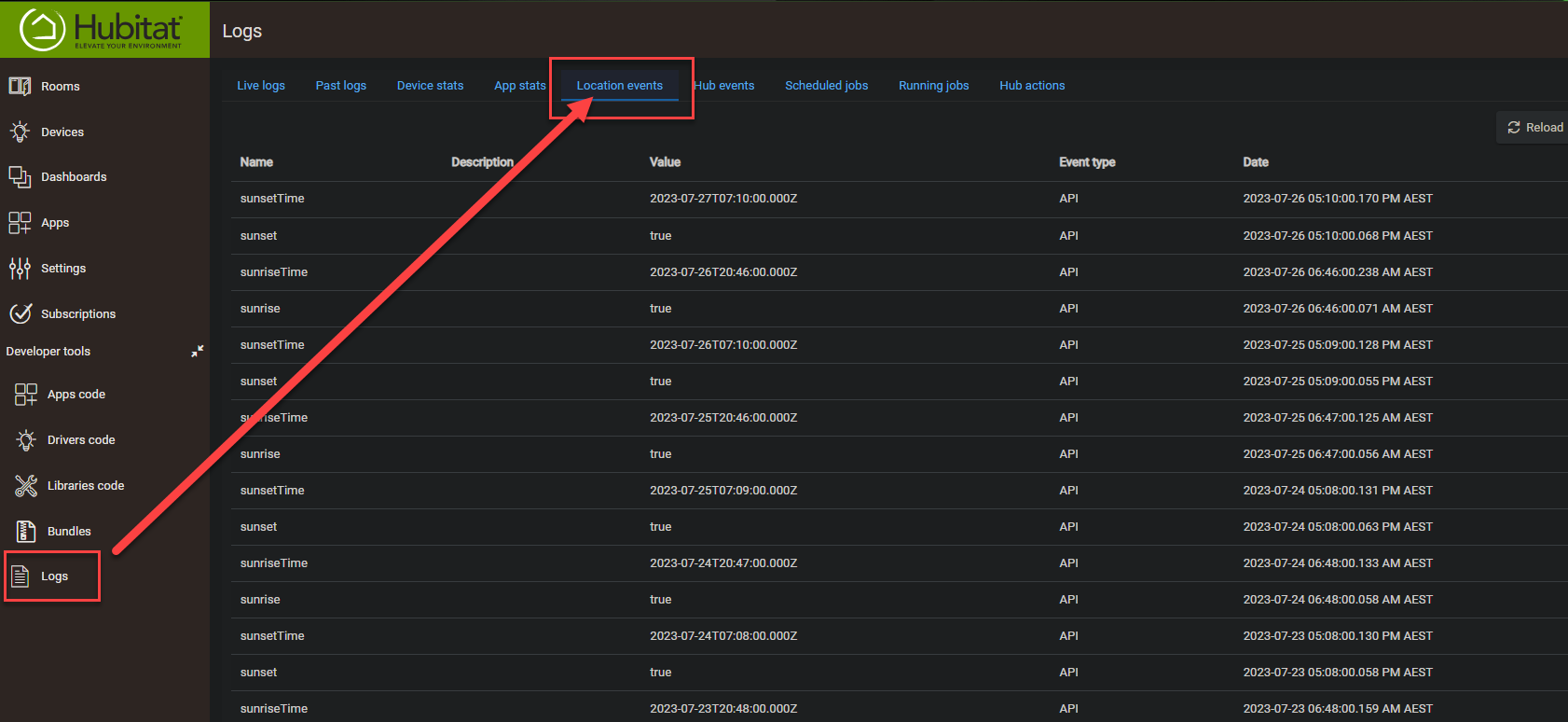

Separately to this, you can also check the Location Events under the Logs page:
If these aren't being set, then it is a question for HE staff and hopefully a case of simply waiting for the events to roll around in the next 12 - 24 hours.

Many thanks the issue was that my Postcode hadn't been set although it was entered during the initial details. Once set it worked perfectly.
