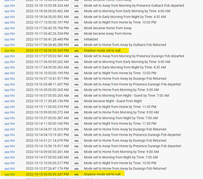

Well, I've let this run a few days as the trouble mode/time is Mon-Thurs. I am still getting the "Shadow mode set to null" in the logs. Below is a screen shot from last few days.
Last night I removed all the modes from Mode Manager, then removed the app all together. I reinstalled MM and recreated the modes as they were before. The issue hasn't changed as seen in the screenshot below.
Screenshot of my Mode Manager page:
I'm stumped... All modes are changing at the proper set time except the 6:00PM home mode. Even the presence changes are working.
@bravenel Any Ideas?
That appears to be a logging issue only. In each case, you've left and the mode has changed to Away. At 6:00 PM you get the log that has "null" in it. But then at 6:26 PM you return and the mode is correctly set to Home. Am I missing something?
Found the bug, and it is a logging bug.
Yes, the mode should change to home by time, even prior to the arrival sensor. That's the way it worked for the last few years with the old Mode Manager. Unless it works differently in the new app, if so how do I accomplish this (Setting home with either time first or presence 2nd)?
That's not how you have it set up. You are telling it to ignore time changes when Away. That's ordinarily how one deals with Away and time changes -- otherwise, what's the point of even having Away?
Well, I have a pellet stove and the heat recovery is not as good as the main furnace. So I have always had the Away mode not go any longer than 6:00pm. So just unchecking "Skip" for away is what is needed?
Correct. You don't need Away in the time table.
