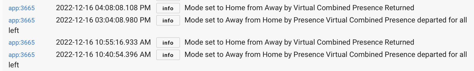

Here are the logs from yesterday, showing that it changed to Home when I returned from Away.
