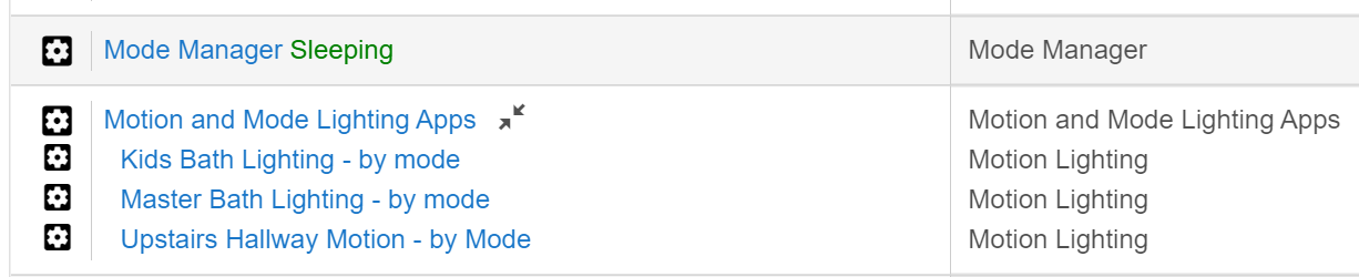

But Mode Manager still says its in Sleeping.

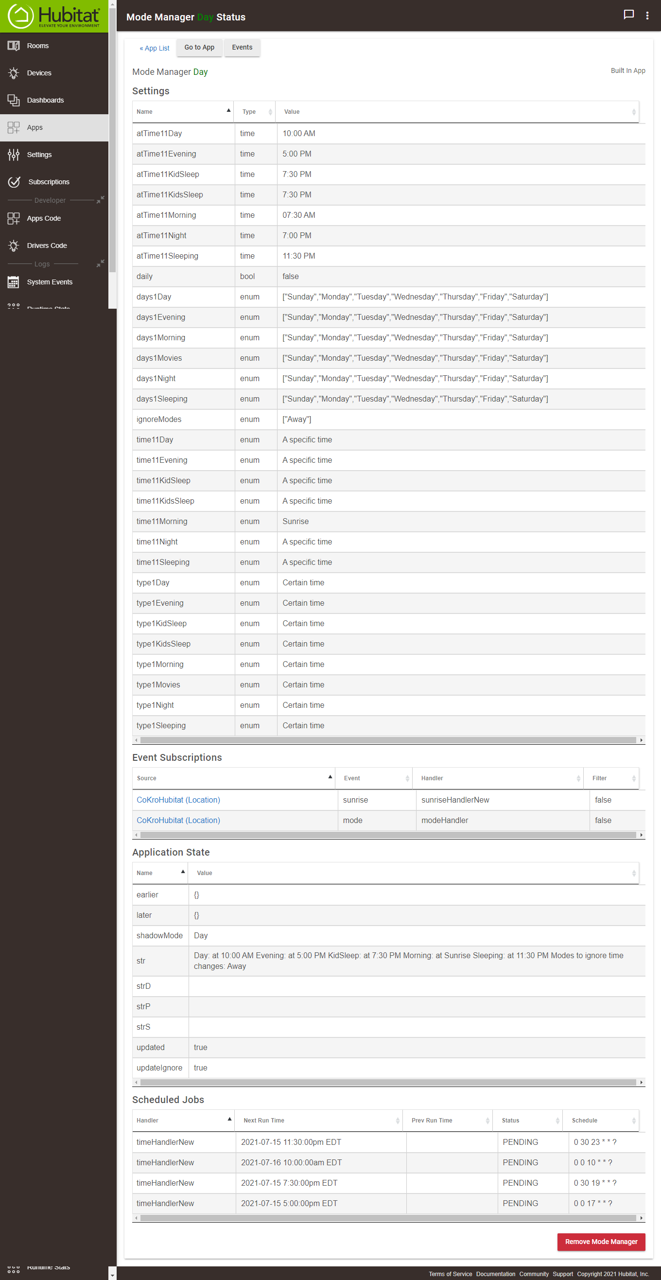

Please show the App Status page for Mode Manager (gear icon).
I thought I made it on Tuesday, but they all blur together these days, don't they?
I'll leave it and see what it says tomorrow.

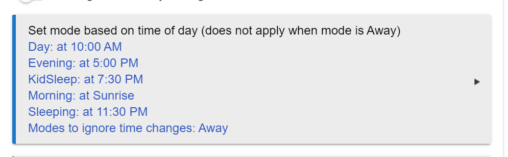

I was pretty certain that I did, since I'd read that could cause issues previously. I even went back and reset it again, ensuring I hit "Done" again. Change still not reflected.

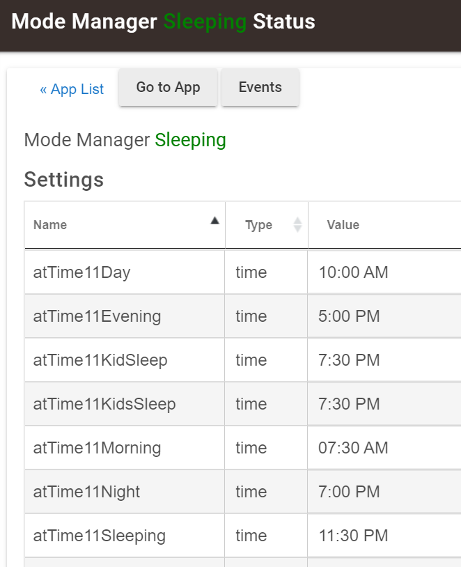

I'm unclear why its showing redundant modes that aren't shown in the app settings. In the gear icon, I see "KidSleep" mode and "KidsSleep" mode, both for 730p.
I need to see the entire App Status page, including Event Subscriptions, Application State and Scheduled Jobs.
sorry. my bad.
That all looks good.

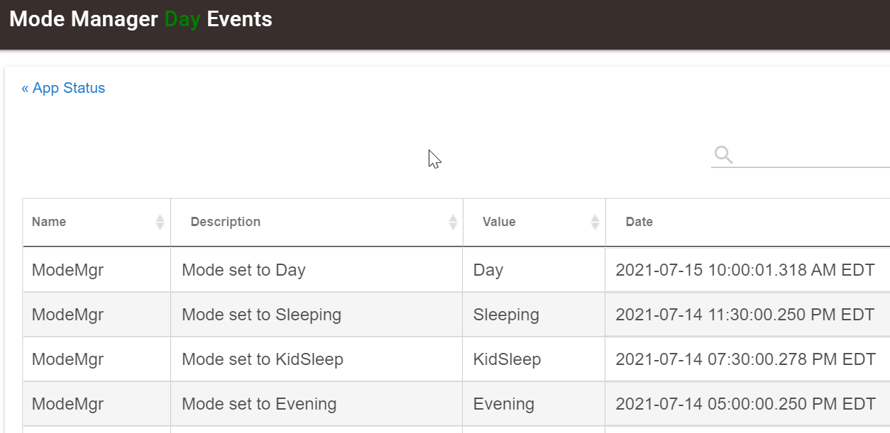

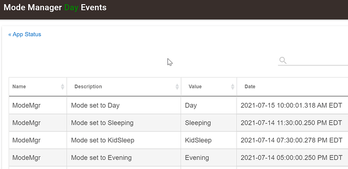

At the top of that page take a look at the Events (no need to post) -- see below. See if it looks right to you. I would expect this to work. But, if you want to be certain, remove Mode Manager completely and set it up from scratch, with your new settings. That would take less time than fussing with it here...
The events look right.
